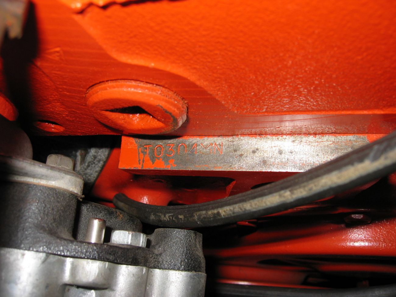

67 SS396 on eBay. Really nice car, but what do you guys think about this block stamping. Looks to have been decked?
Mark

Thanks. My concern is more what appears to be circular machining marks. They are very light, but I swear I see them!

It looks like a restamp to me.

pic I had of a similar date I think.

Tony heres the pad from the car you found me.

Notice how high the center of the W is pointed on mine vs the one at auction.... IMO it is a restamp.

Thanks! Yours looks much better! That pad is perfect!
