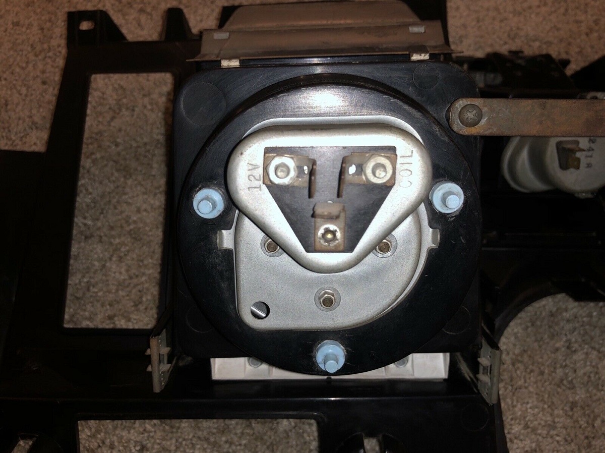

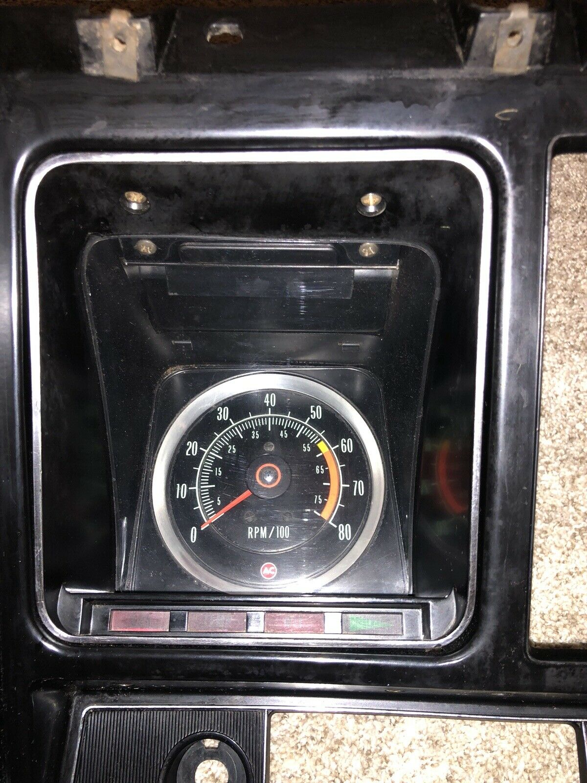

Old 11-18-2019, 04:01 PM
chris slawski chris slawski is offline
Join Date: Mar 2012
Location: New Jersey
Posts: 398
Thanks: 185
Thanked 115 Times in 64 Posts
Default photos
so thoughts?

For comparison, here is my L34 born with tach. Is yours date stamped?
IMG_20160528_095144 by Dave H, on Flickr
IMG_20160527_222550 by Dave H, on Flickr
IMG_20160527_222514 by Dave H, on Flickr
IMG_20160527_220928 by Dave H, on Flickr
-Dave

Old 11-18-2019, 07:09 PM
Location: Santa Cruz, CA
Posts: 6,562
Thanks: 392
Looks legit to me.

Old 11-19-2019, 12:09 PM
Join Date: Mar 2012
Posts: 398
Thanks: 185
Thanks folks!
Dave H i am going to wait until later on in the resto to check for the date code. I can just see my ham fists somehow breaking off a stud!
Old 11-19-2019, 05:39 PM
HawkX66's Avatar
HawkX66 HawkX66 is offline
Join Date: Sep 2015
Location: VA/MA
Posts: 1,021
Thanks: 1,015
Thanked 225 Times in 134 Posts
Originally Posted by chris slawski View Post
Thanks folks!
It comes out very easily so don't sweat it. I think I just used a 1/4" drive socket without the ratchet attached to unscrew the nuts.
