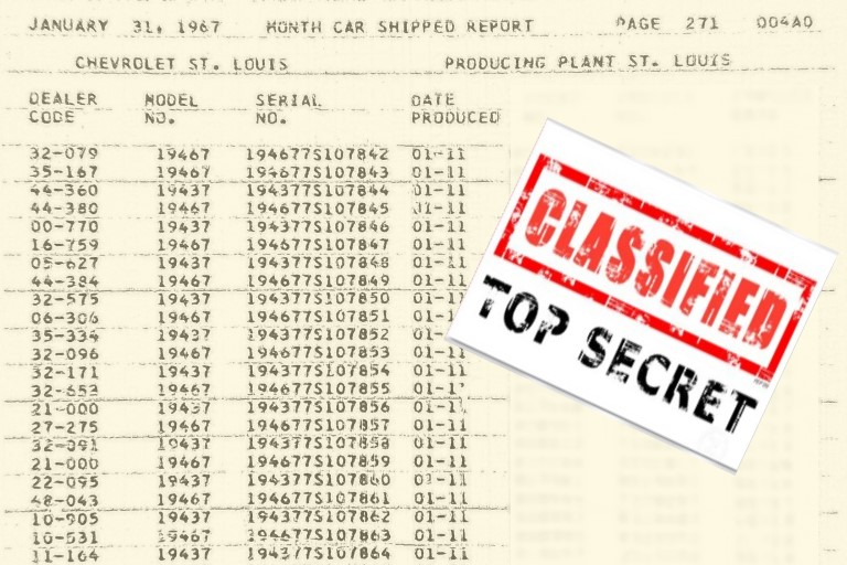

I have a question about the "Month Car Shipped Report" where the NCRS document service data comes from. Does the original Chevrolet report contain the option codes or not?
An image from just one microfiche page would be the definitive answer

No, it only has the VIN, the order #, the dealer, and the date. That's it.
Kurt S - CRG
Can you show us one of the pages from this report? The Canadian ones are easy to find.

Nice summary from a CRG post by John Hinkley (johnz)
The body number on the cowl tag was assigned when the plant accepted a dealer order for production; the dealer order number (which was pre-printed on the dealer's order blanks) didn't serve any direct purpose on the line in production, although it followed the car on all the Chevrolet paperwork (Broadcast Copy, window sticker, Car Shipper, etc.). The body number on the cowl tag showed up as the "Ident Number" in the top row on the Broadcast Copy, and also showed up in the upper right corner of the window sticker and Car Shipper. In the scheduling computer, that number tied the unit back to the specs on the Dealer Order.
