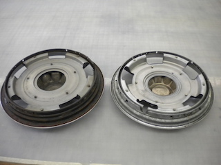

Default Mag cap comparison
The cap on top is the '67-'68 version, bottom is '65-'66. Primarily the '66 cap has smaller vent holes and the center cap appears separate from the spokes while the '67 cap has larger holes and the center cap appears molded into the spokes.
I believe the painted spokes came in '69 or '70??
Willow green is a great color, really pops in BC/CC!!
Bill W
