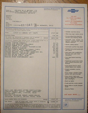

Default 1969 Copo
http://newyork.craigslist.org/fct/cto/5920743716.html
1968 ChevyII 396 375,1969 Camaro 396 375 survivor , 1969 Dynamotion Copo Camaro,1968 L 79 ChevyII ,1969 Camaro 427 ratsness ,1967 Chevelle L79

Default 1969 Copo - Rebody?
Subject VIN 124379N661041
Reported rebody as info @ 1'st link below but any ever ads seem to tout originality?
Copo Connection paperwork also "sensitive restoration" mentioned in description at 2'nd link.
[img]<<GRAEMLIN_URL>>/hmmm.gif[/img]
SYC 2012 thread...
https://www.yenko.net/ubbthreads/ubbt...;Number=476278
Carpictures? link...
http://www.carpictures.com/1969-chevrolet-camaro-copo
Hemmings Ad link...
https://www.hemmings.com/classifieds...o/1845485.html
VIN 124379N661041 - Rebody?
Trim Tag Body # NOR35147(2-4?)
Camaro COPO 9561 AA
Cortez Silver - 711 Black
L72 M22 D55 D80 G80 G84 PL5 U17 ZL2
Shipped June 25/69
Delivering dealer - Golden Mile Chev/Olds Toronto

I was offered a silver Canadian documented Copo w/M-22 &quot;rebody&quot; for 50k probably 10-12 years ago... I passed... likely suspect.. I probably have the info on the car somewhere..

The registration history for this Copo show a wrecking yard in St. Catherines ON in the late '80s.

In the second link it says this car was the personal car of Jim Mattison...hmmm... maybe not the same 'rebodied' car that I was offered??

Lots of great cars saved from wrecking yards so that alone means little without other info.
Saw the Jim M. note and wondered if it was referring to his early years @ GM or just meant to sound that way...then read the other info further below which seems to belong to this vehicle too?
Especially if clouds around this car untrue, best someone step up w/ some solid truths.

Yes, its just another original drivetrain &quot;very little in the way of body repairs needed&quot; as the previous ad states, Copo Camaro found in a junkyard.

Nothing like having two different Window Stickers made for the same car.
