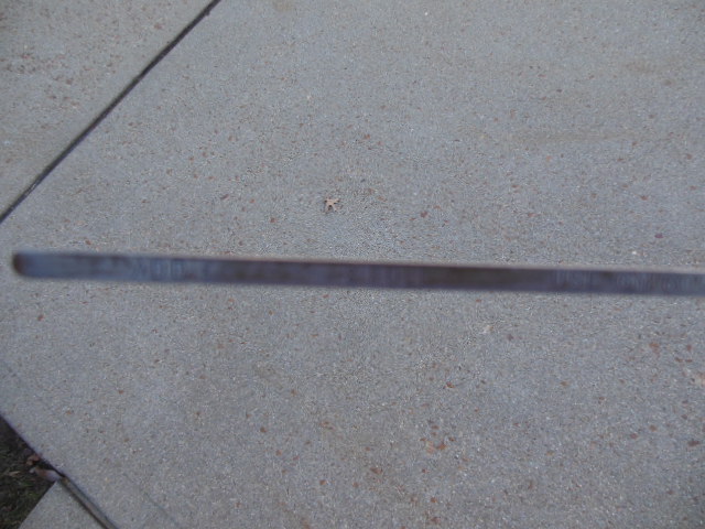

Found a dip stick thanks to ALLZS. Still looking for a nice set of original 3932417 dripper style covers used on late 69 Z/28's and 70 LT-1 motors.

Old 01-05-2020, 05:40 PM
ALLZS ALLZS is offline
Join Date: Dec 2007
Location: ST LOUIS MO
Posts: 1,961
Thanked 121 Times in 66 Posts
should have the dip stick nice used original I will look tonight

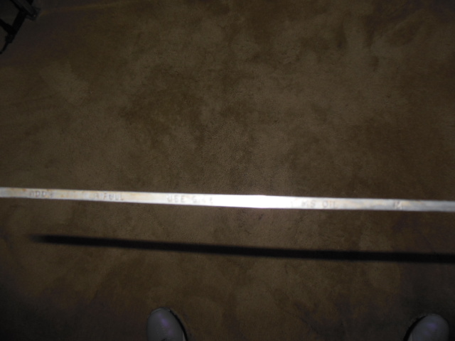

Old 01-06-2020, 12:17 AM
Join Date: Dec 2007
Posts: 1,961
Default dip stick
here is the one I have
