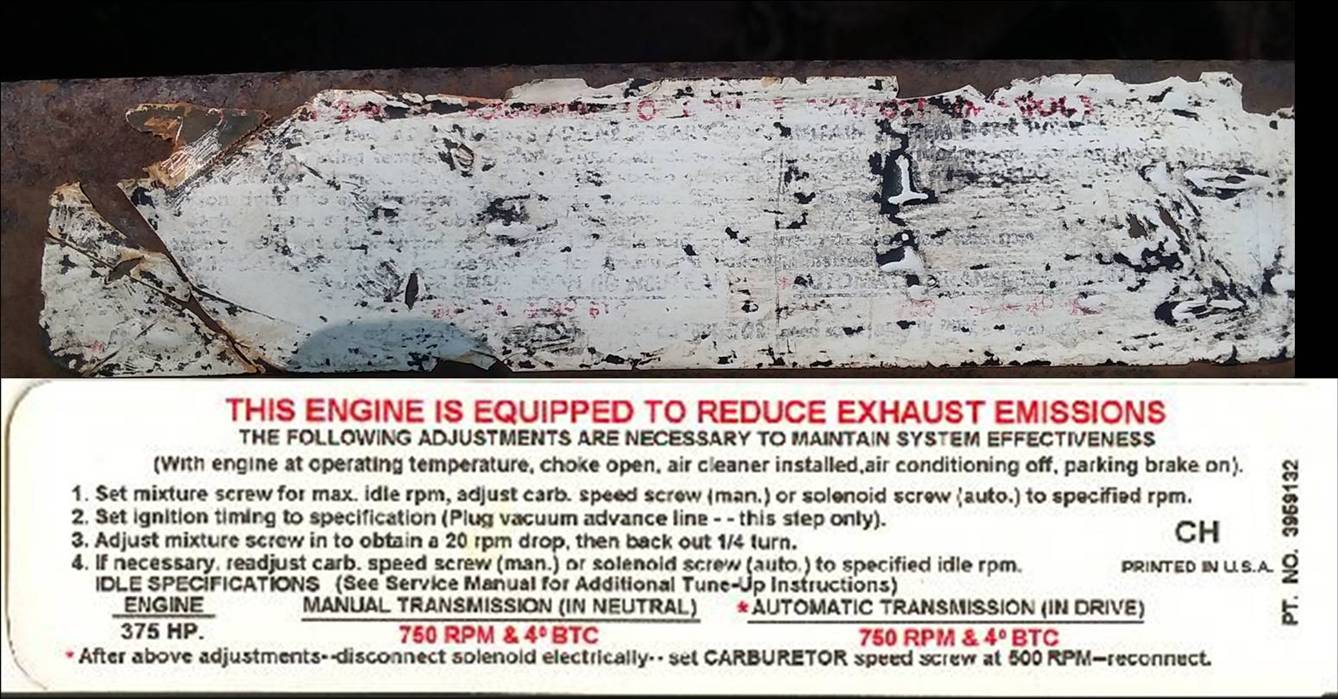

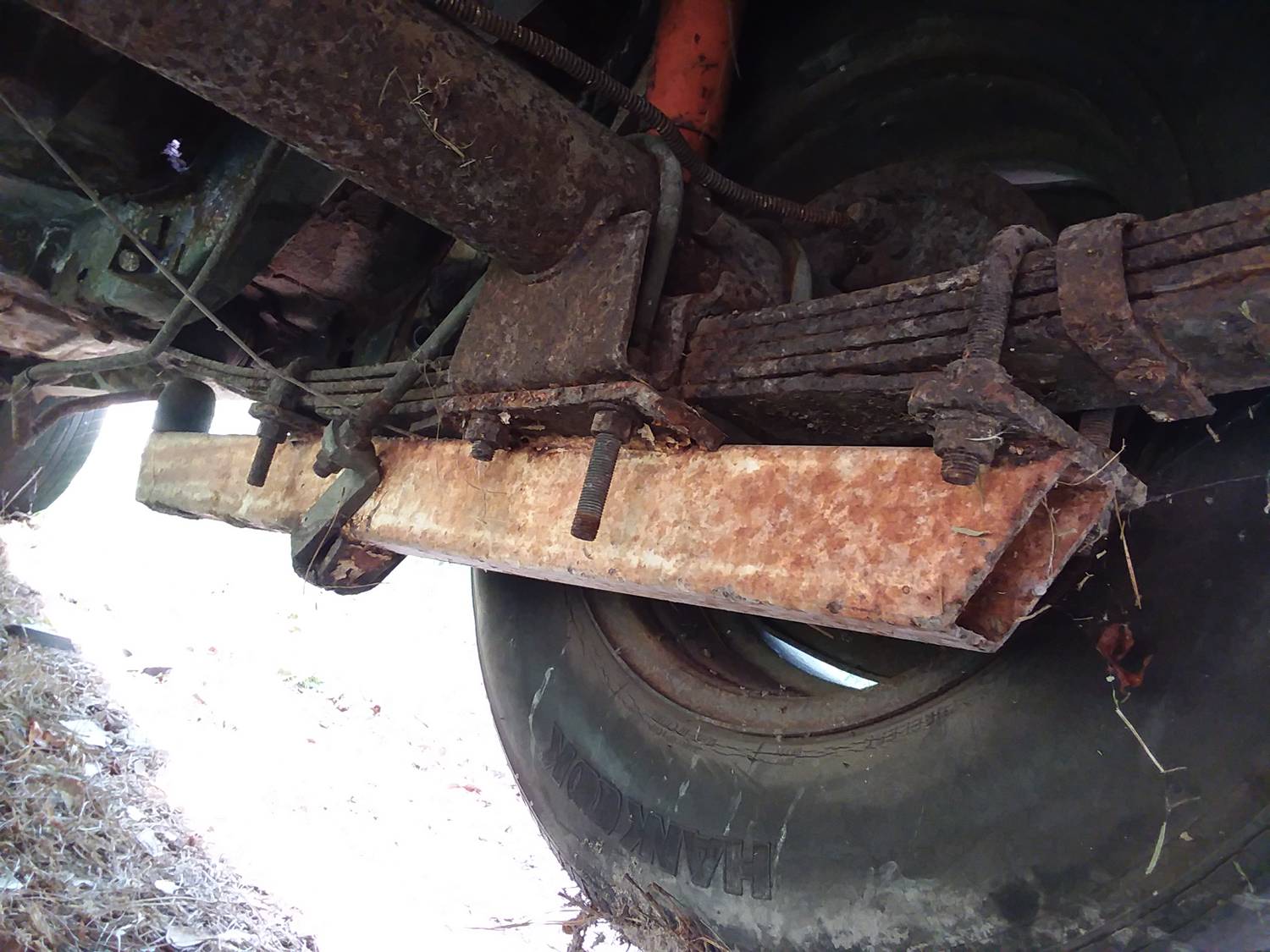

Hello sYc, I wanted to share some info and pics of a 1969 Camaro a friend of mine picked up. We got the car and being a numbers guy I began checking it out. The engine and trans are missing and it is quite obvious the Camaro had see some race days- wheel wells opened up for large tires, tow tabs, and a sun tach box on the drivers inner fender. Now keep in mind i am Chevelle guy and still learning Camaros, so the CRG pages are worn out from my search for info. the body tag shows X11, the bulkhead has X1 written on it as well. it has black deluxe interior (712). Where it begins to get interesting to me is it has a big block heater cover, the cowl hood harness and throttle arm. there is a 12 bolt in the car but we have determined it is not the original unit, the Camaro is a 03D build and the current rear end is BU1112G1with the E below it. it has traction bars but i am not sure of the manufacturer, they are angled on both ends and use the J bolts. The body is Daytona Yellow (76-76) and there appears to be a single black stripe on what remains of the original yellow paint. The core support appears to be the original and still has the tuning decal on it even though it had been painted over at some point,I carefully removed the paint and it appears it was a CH or 375hp tuning decal-the image shows the original one on top and an example of the CH decal below. We received the NCRS document and it identified Baldwin Motor Co as the dealer and Mar 26 1969 as the production date. Well just wanted to see if anyone might know of some good sources for tracing info related to Baldwin and anything else we might be able to check to identify more info about this interesting Camaro. Thanks Andy

The traction bars dont look like Motion Super Bite traction bars... they look like the 71ish Lakewood Grumpy redesigns with rear clamping for deceleration stability... however... as most know.. Joel and the boys would put whatever you wanted on the car at your request. Being sold at Baldwin its probable that the owner did what most did.. went to the shop and bought individual Motion parts to get close to a Motion car spec.

Wow, that one is certainly a bit crusty. It does have a lot of signs of being a COPO with the BB heater core and single 3/8" fuel line. I would suggest pulling the heater core and checking the date code to help determine if it is original to the car. As mentioned the rectangular traction bars are '71 or later.

appreciate the input. definitely an interesting camaro. i did notice one baldwin listing in the registry and it is in the same vin range but later. i will try to verify the date on the fan motor and provide an update. thanks again

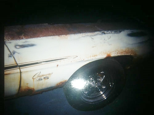

do you have a picture of the complete car?

I have only seen one pic of a Motion car that appeared to be a COPO but it wasn’t yellow and was without style trim.
The pics are from an article in Hi Performance CARS (November 1969) featuring the installation of the Hone OD. It was a 427, auto on the column, 4:56 rear. The article says owner Marc Cohen drove it back to his home in Ohio from New York, and referred to it as a Phase III car. It doesn't really say if it was a Baldwin purchased car or if he brought it in to be Phase III tuned.
