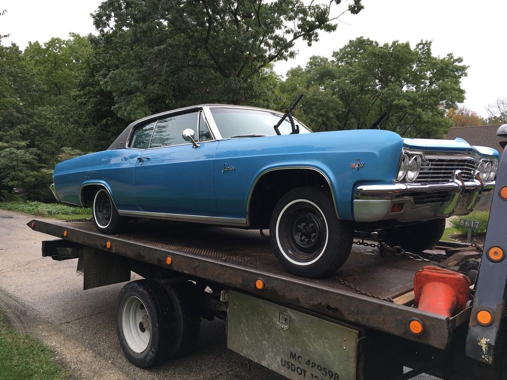

I met Andy at the Elkhorn Swap meet a year ago and we were talking about the LS swap into the 66 Impala Convert.....We got hooked up again in early summer this year and were talking about the Ackermann issues these "B" body cars have........Ended up Andy had the GM Service Bulletin from 1966 resolving these issues .........Anyhow......Here we go again........LOL......
Staring point is a pretty nice rust free Caprice.........Putting in a LS3 480 HP/4L70E GM connect and cruise set-up just like we put in Gary and Keith's cars.....
