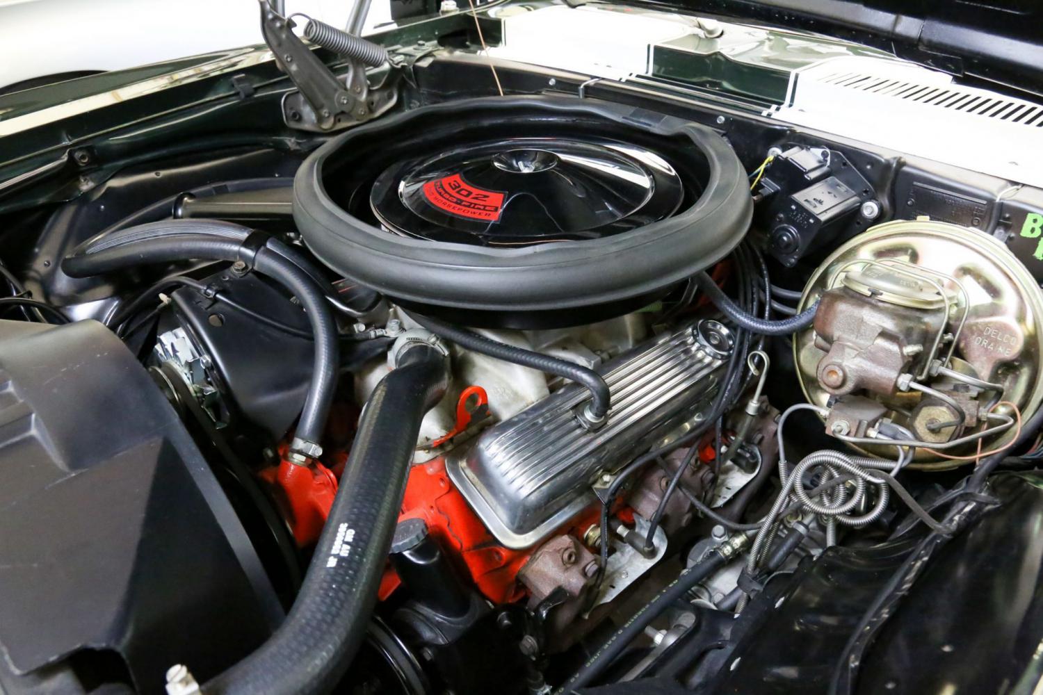

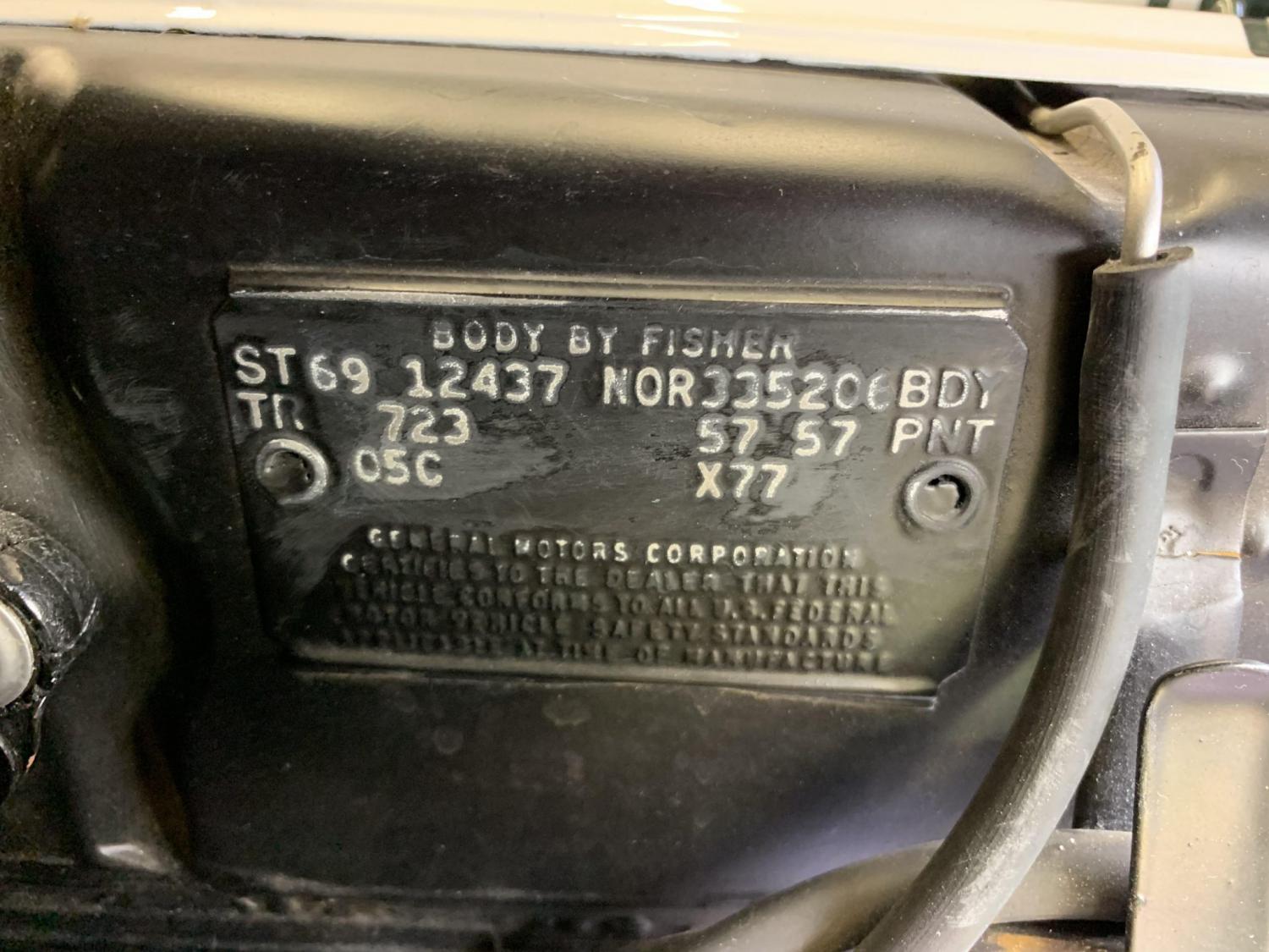

NOM, some black interior components for a green interior, looks like sold in 2010 at Barrett-Jackson Vegas. Cowl seal on backwards, sanded tag, aftermarket Hurst? I do dig the stance, and the Flowmasters sound lovely too. Looks like a fun driver!

What possesses people to sand cowl tags!!
Rant over

It’s the same POSSESSION that comes over them to Sand and Scrape the paint off an engine deck pad. LOL
THE DEVIL!!

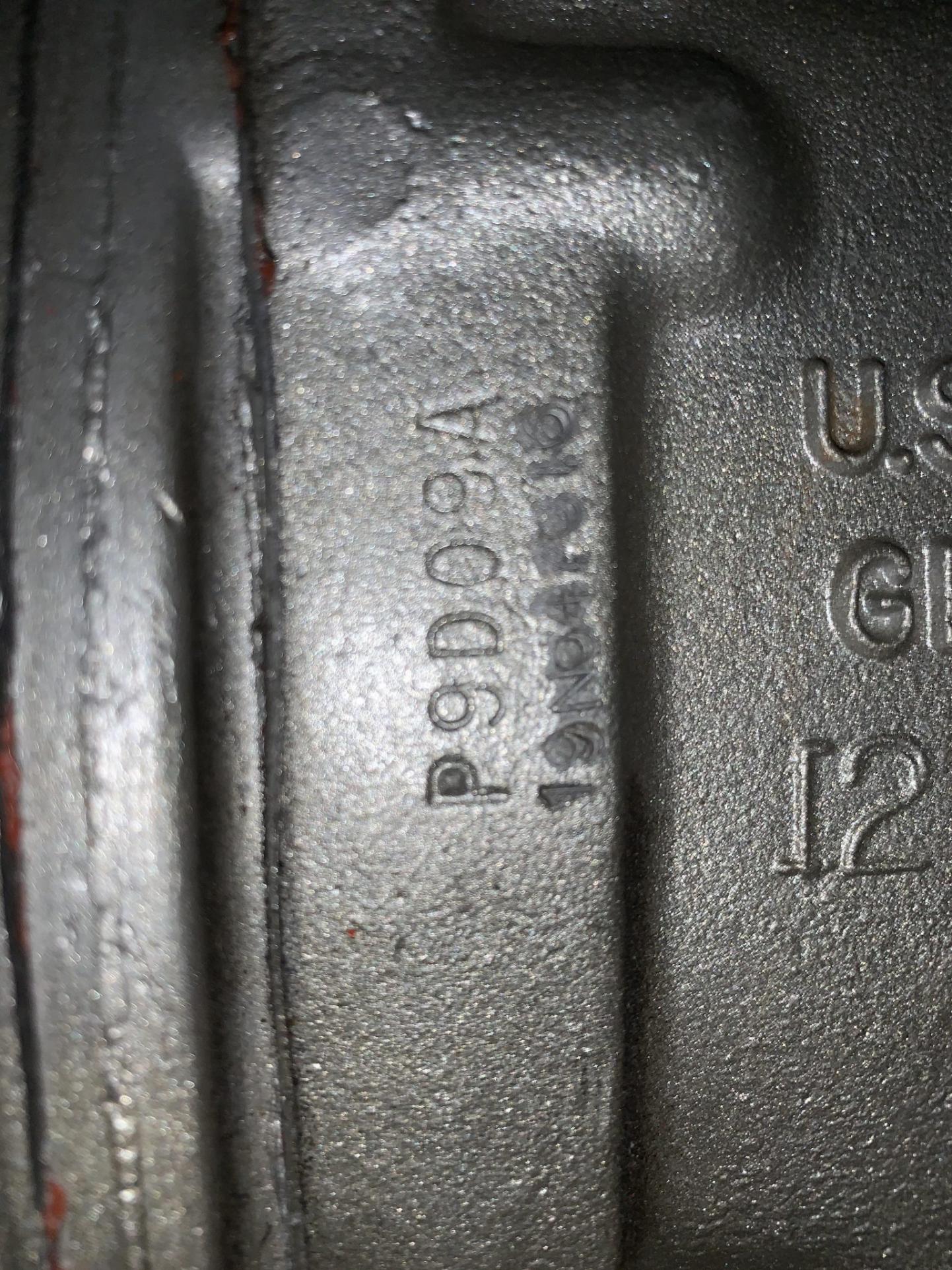

Trans and axle stamps:

At least the cowl tag is real...
Easy way to get the numbers & letters to be read clearly

Doesnt look like any of that drivetrain is original.
VIN stamp on trans is not factory.
Chinese booster.
