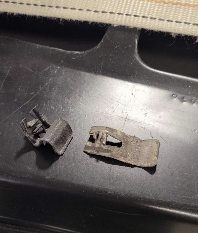

Default Muncie Speedometer Cable Clips
My clips are all beat up. Anyone have a good original clip or two?

Bill,
I would just straighten yours for those little suckers are expensive.

Thanks guys. I think I can make this a happy ending if I can get the one rounded out again without breaking it.

Go slow and use a "form" to apply even pressure to avoid "work hardening" it and you should be OK. This metal is very soft (and not very strong)which is how it got the way it is so easily.

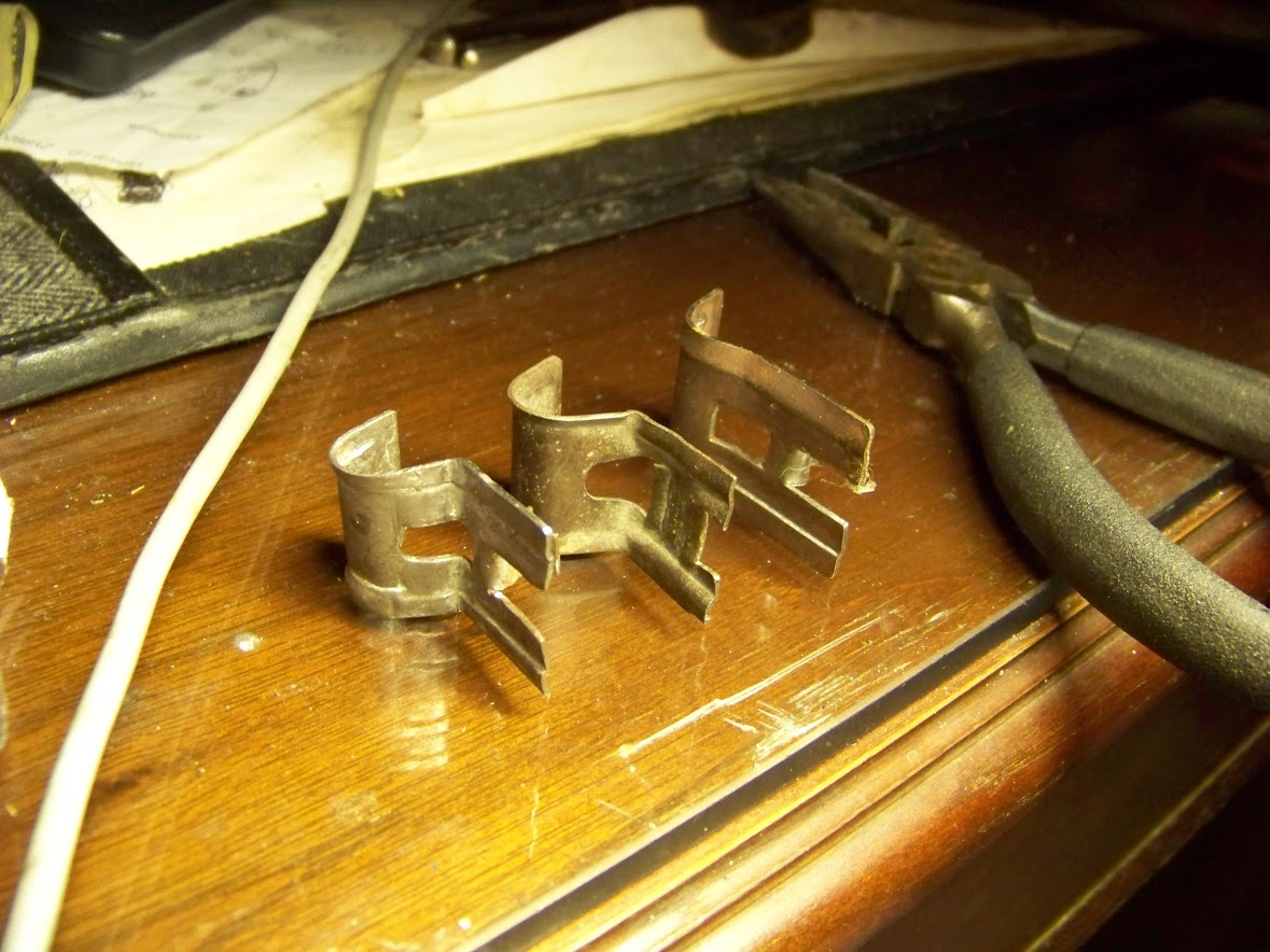

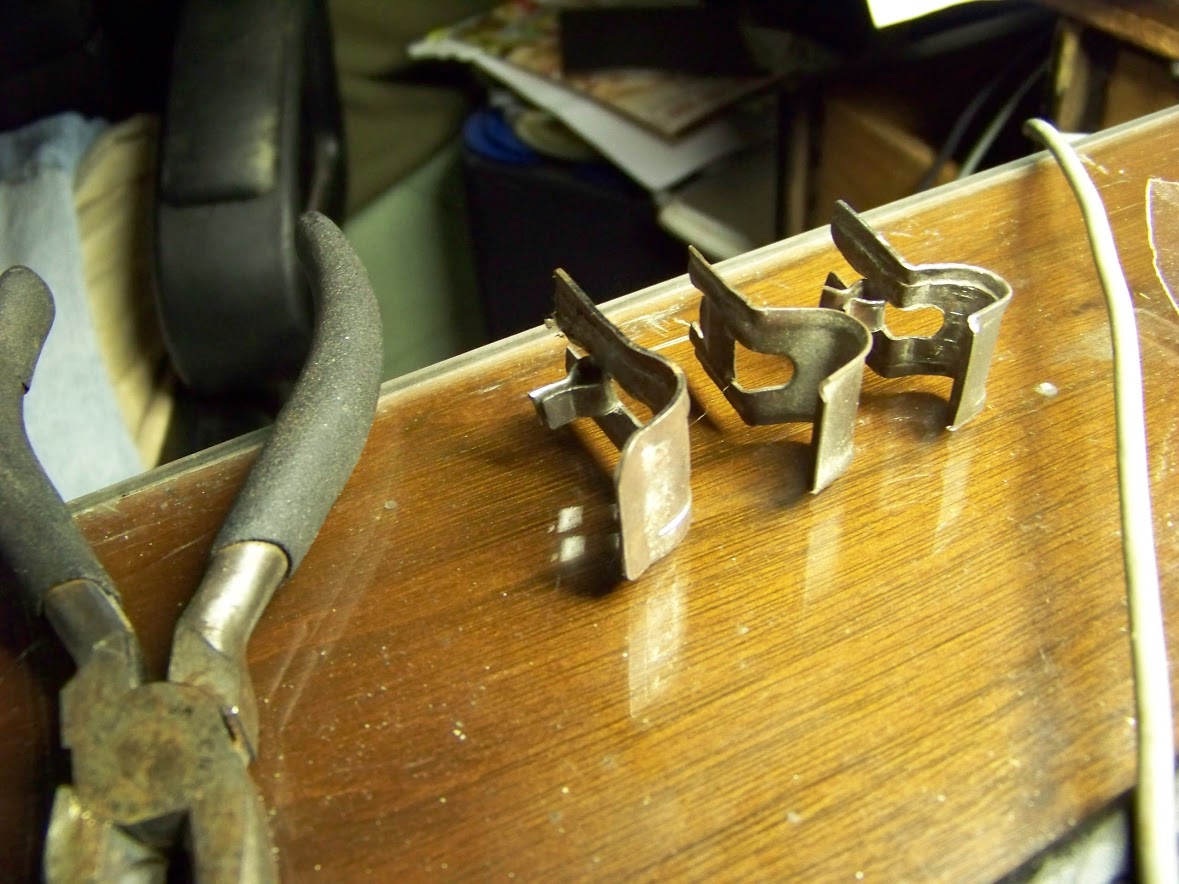

The HBC ones are the same as everyone offers...
They also have to be "worked" in order to make them look correct!
To "fix" the clip took a good deal of work, making a little anvil and die and then filing using a multitude of needle files to fix errors.
First photo from left to right...
REPRO - ORIGINAL - Modified repro.
