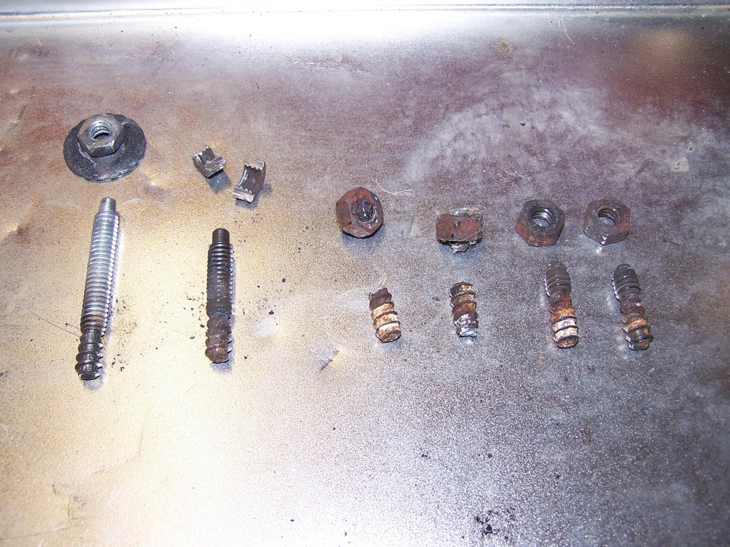

Hi folks,
The original spoiler on my '68 L78 car sheared a few studs when I removed it from the car, and a couple other studs stripped out the fiberglass holes when I unscrewed them from the spoiler. The spoiler itself is quite nice and is original to the car, so I do plan to fix the stud bosses. I have heard people having good luck drilling the holes oversize and filling with JB Weld, but I'd like the opinions of the folks on this board before I tear into it. Appreciate the feedback!
-Tony

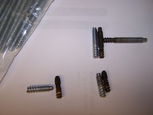

For a 1968 Stud I choose Mcmaster carr Steel Wood Screw Threaded Studs
Cut down and machined the nose of the 1/4-20unc end to replicate originals.
Do yours look like this?

Yes.
https://www.mcmaster.com/wood-screw-studs
When I look at ebay or Heartbeat the offered replacement studs have a hex flange, I am not sure of the proper stud on a production 68 & 69 Spoiler.
My 68Z w/ an Owner modified "GM" spoiler has the style pictured above & McMaster does offer the stud in stainless.
