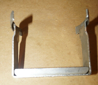

you need Kent Moore J-22598 to get the collar off.
https://picclick.co.uk/Kent-Moore-J-...326403184.html

I tried today with a claw puller but the case tapers around the back of the collar. Looking for a good diagram that shows how a puller is supposed to attach.

the curved 'jaws' fit under the rolled upper lip of the collar. i've used the tool and it works.
