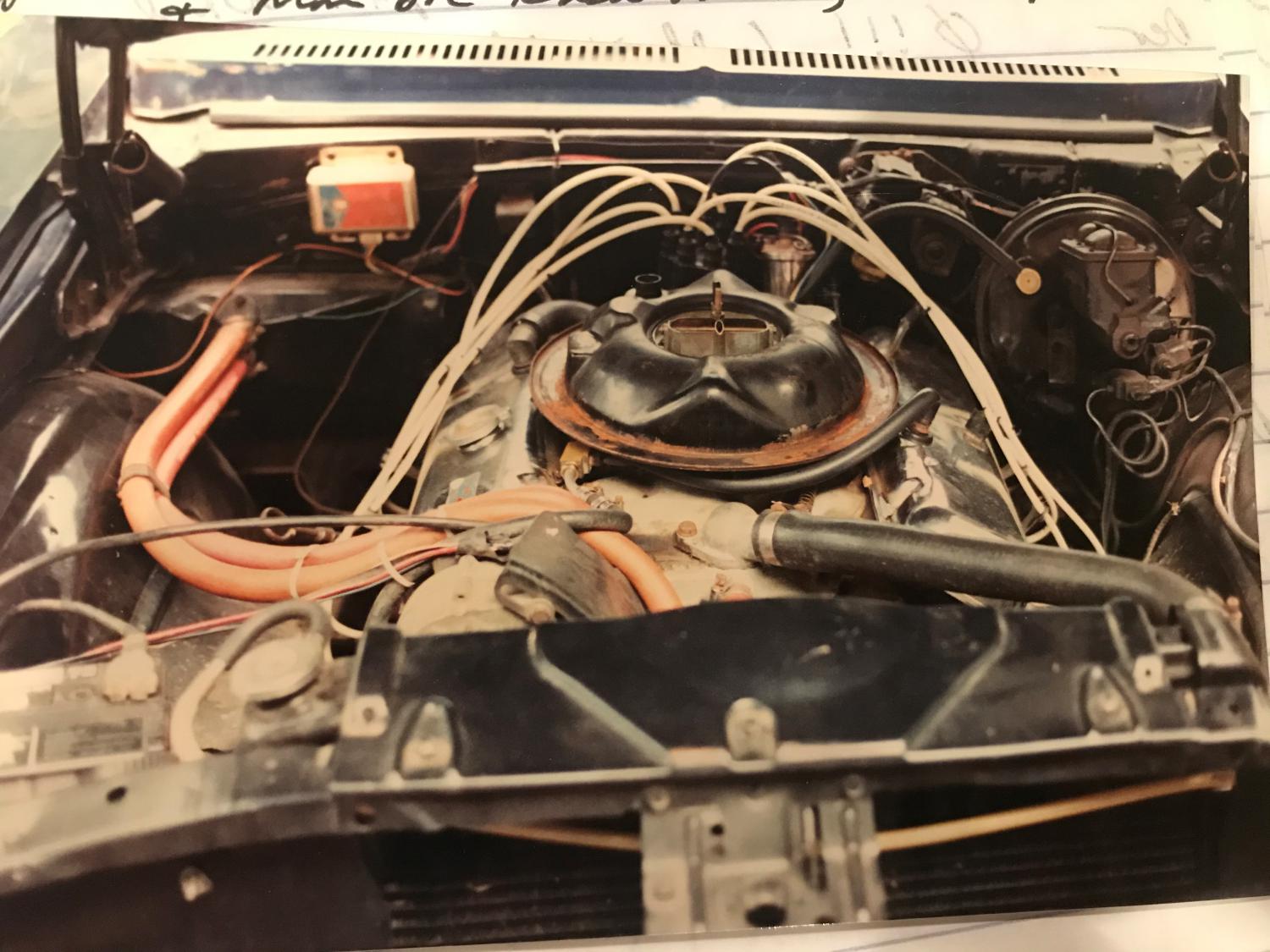

Fast forward to two weeks ago. I have stayed in touch with the prior owner and he called me and told me he had found several pics of the car from 1988 before it was refurbished by prior owner as well as an album of pics during resto. To say my son and I were excited to pic these up was an understatement. Interestingly, pics seem to reveal a single 3/8 fuel line, L78 core support, etc. I would like to see what people much more knowledgable about these cars think. Financially, I could care less--I have no plans to sell the car and when I am old it will go to my son. It is simply for historical purposes.
Do you think this was originally an L78? Any other clues you are seeing in pics?

The info you have posted points towards on an original L78 car with the TH400 trans. I think you have a typo for the block casting number...should be an 854 block, you repeated the cylinder head number.
the radiator tag [ZE] is a winner and a hard to find item...all the other stuff [carb/dist/tranny] lines up pretty good. Somebody added a small block radiator top plate...all the BB cars had a rubber flap with plastic pins [70].
Engine bay photo shows the low profile intake and other BB features...
does it have a 5 blade fan???
if you check the trans near the shift linkage you may find the VIN on the pan rail...later cars had them on the bell housing.
looks like a cool car...more photos pleae

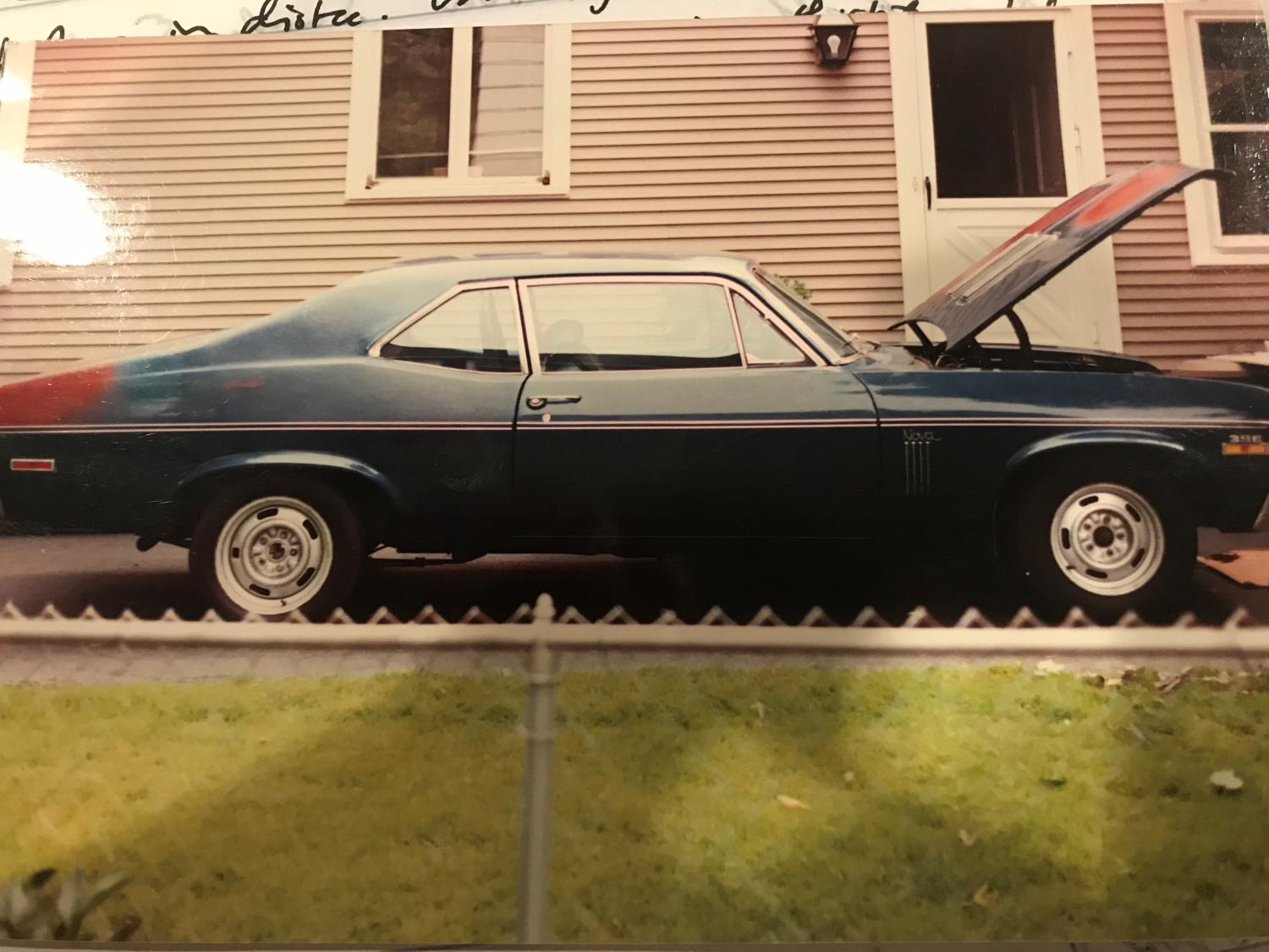

I have uploaded several more pics. The first 3 are of the car prior to restoration in 1988-1989. It appears to have been a pretty solid car, certainly not from NY most likely. Price for car was $5000--1970 Nova L78 52,000 miles is noted on back of pic. From the before pics, it does not seem like full quarters needed to be done. However, the owner at the time did not appear to want any patch panels and thus quarters were replaced as well as wheel houses with NOS GM at the time sometime in the 1990-92 timeframe--on back of the pics he states " no shortcuts, any panel with rust was replaced with full replacement panel from Chevy dealer" He tabulates on back of final pic that he so far had spent over $20,000 at the time in paint, bodywork, mechanicals etc not including original cost of car. The restoration seems to have been a high quality job, and the car is an absolute joy and blast to drive. No squeaks, rattles, and everything still closes nice and tight and solid. Paint is still very nice almost 30yrs later with no bubbling, rust, etc. The engine is a torque monster and smokes the tires through all gears and turns the car sideways when floored--it has not been rebuilt since 93. The sound of the mechanical lifters at idle is pure and utter joy!

Here are pics sometime in 1988-89 prior to restoration

This car looks like the real deal in every respect...BB radiator support with the large opening and small holes for the rubber flap.

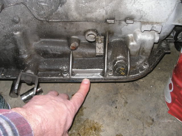

#regarding the search for the trans VIN...first the tag with the CW code is very important...the L78 got this tranny. If you look on the driver's side pan rail near the shift arm you will likely find the VIN stamp. It is typically stamped on the flat surface, so you need to clean the area and use a mirror to see it. One of our later build L78/th400 cars had the VIN on the pass side bellhousing lip up high near the back of the motor. I still think you will find it near the shift arm...you may also see the CW ink stamp [in pink] on the transmission housing...of course it may require some cleaning to see it. Does the tranny have the 6 lug convertor??

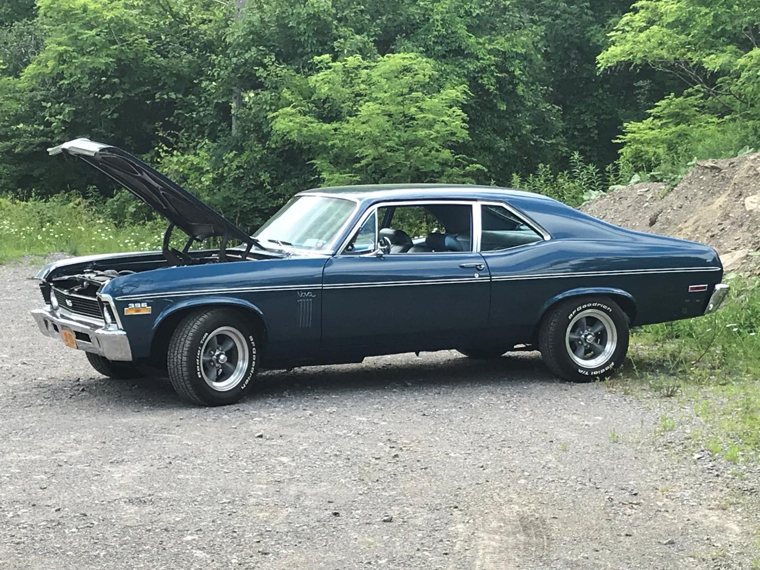

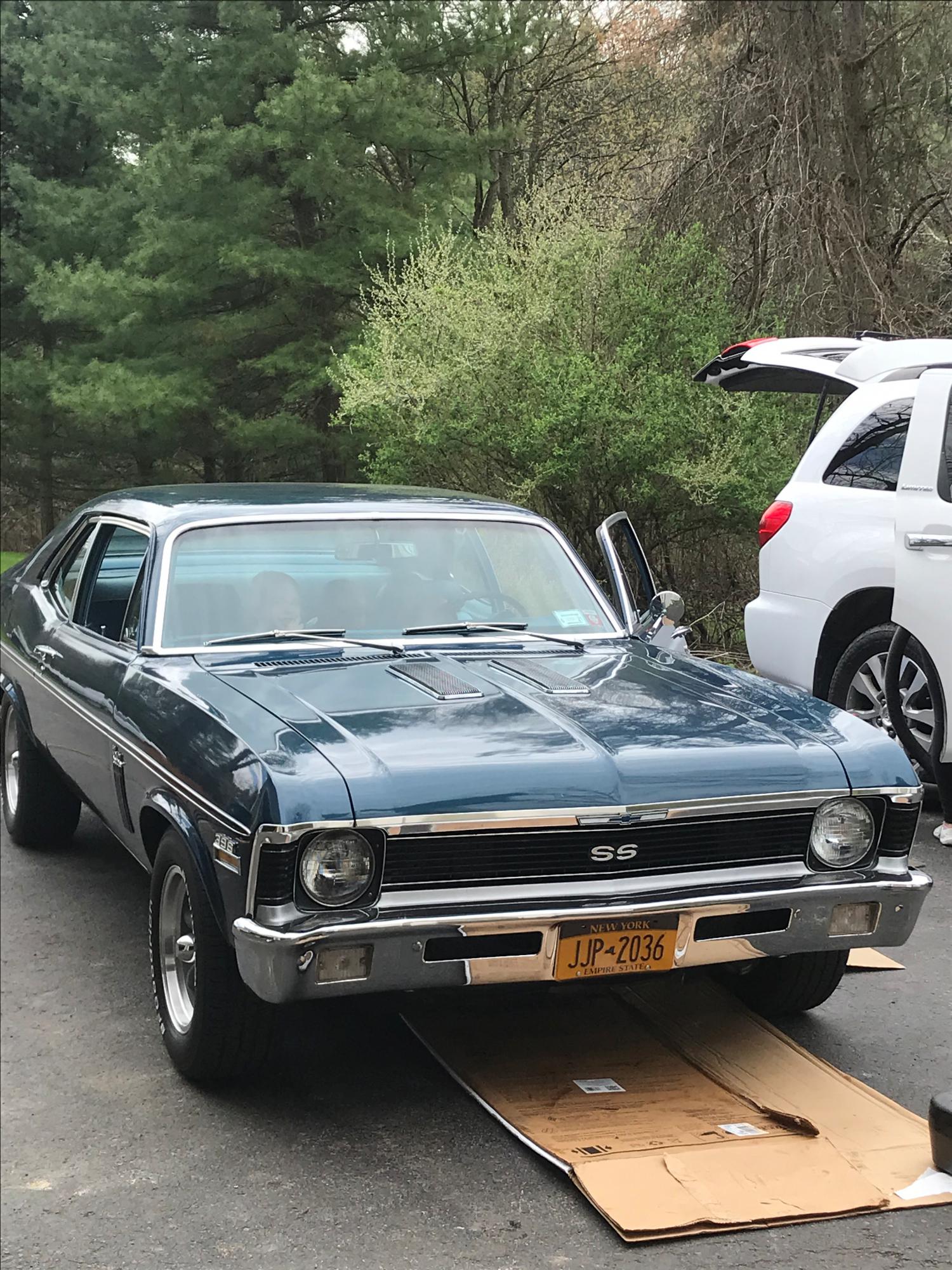

Thanks for the comments guys! Here are some recent pics. Trying to put together a set of poverty caps for the Spring
