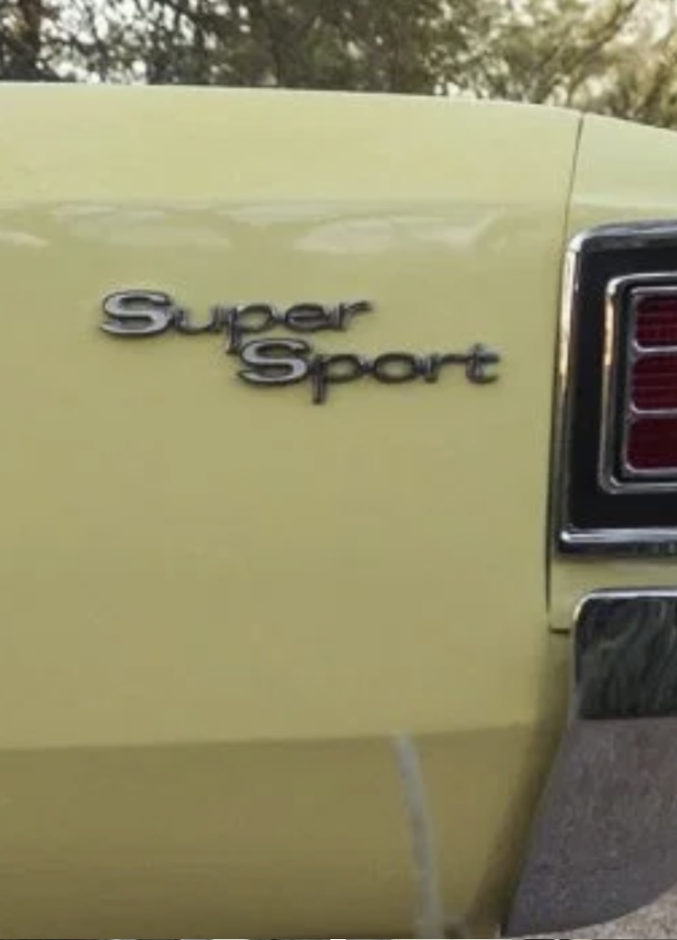

Default 67 Chevelle SS396 on BaT
Looks like an original 3 speed manual car which now has a 4 speed. Better check that panel between the rear window and the trunk lid for rust repair since it was originally sold in and spent some time in northern IL.

That 'ol 3 speed was never OEM in this or any other '67 Chevelle SS.

2L on trim tag indicates factory M20 4-speed car, and POP indicates a Muncie 4-speed code. Neat original trans date on POP - P7M22 !

I’m not sure I love how that emblem is placed. Might be just me.

It's not just you, Mike.....one of the earliest comments in the auction, someone else questions the placement also. Since the rear quarters have been replaced, someone probably just did a poor job of relocating the emblems.

I was being polite or maybe sarcastic. LOL I saw it immediately
and when I see that, I think poor workmanship by whomever screwed it up and I’d pass based on that alone.
