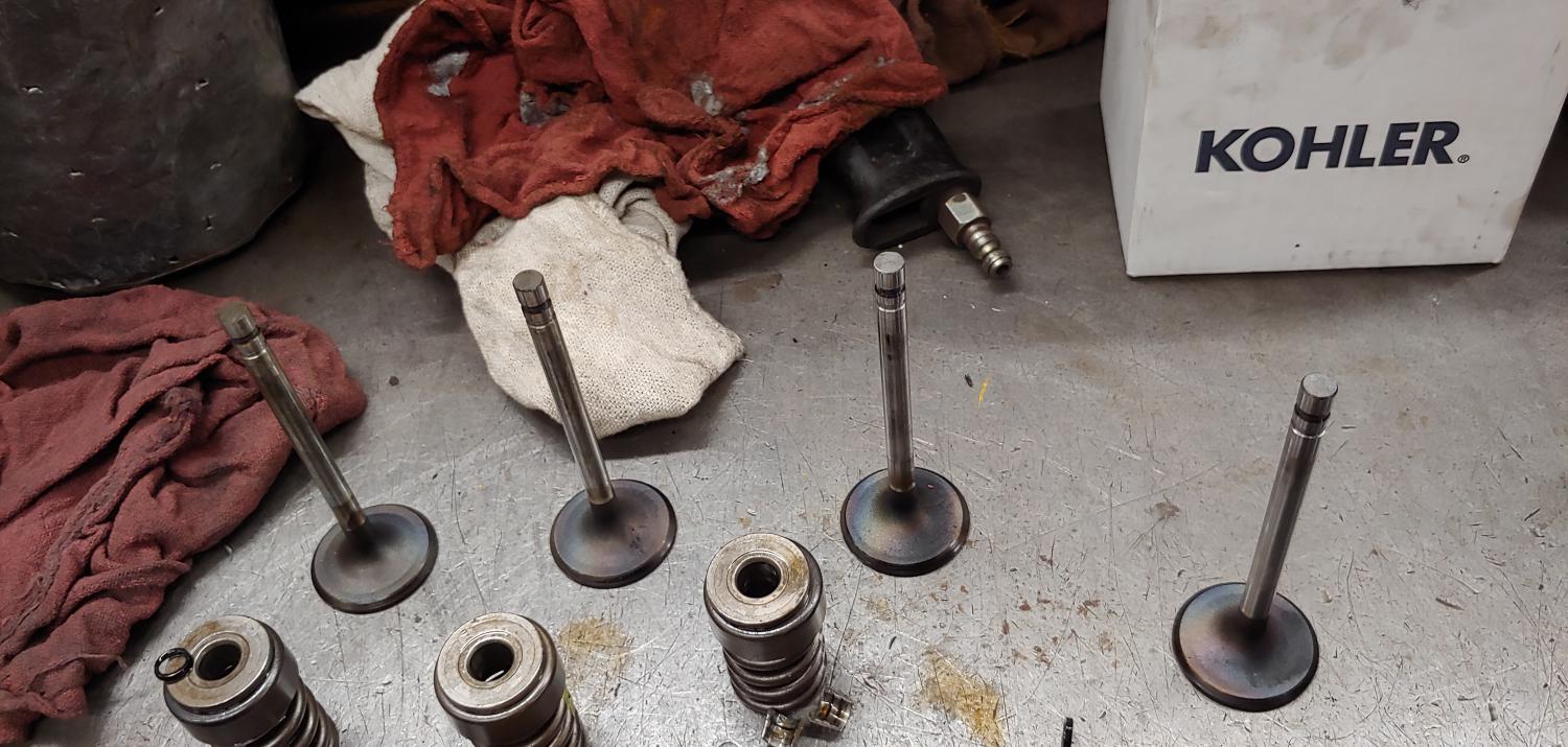

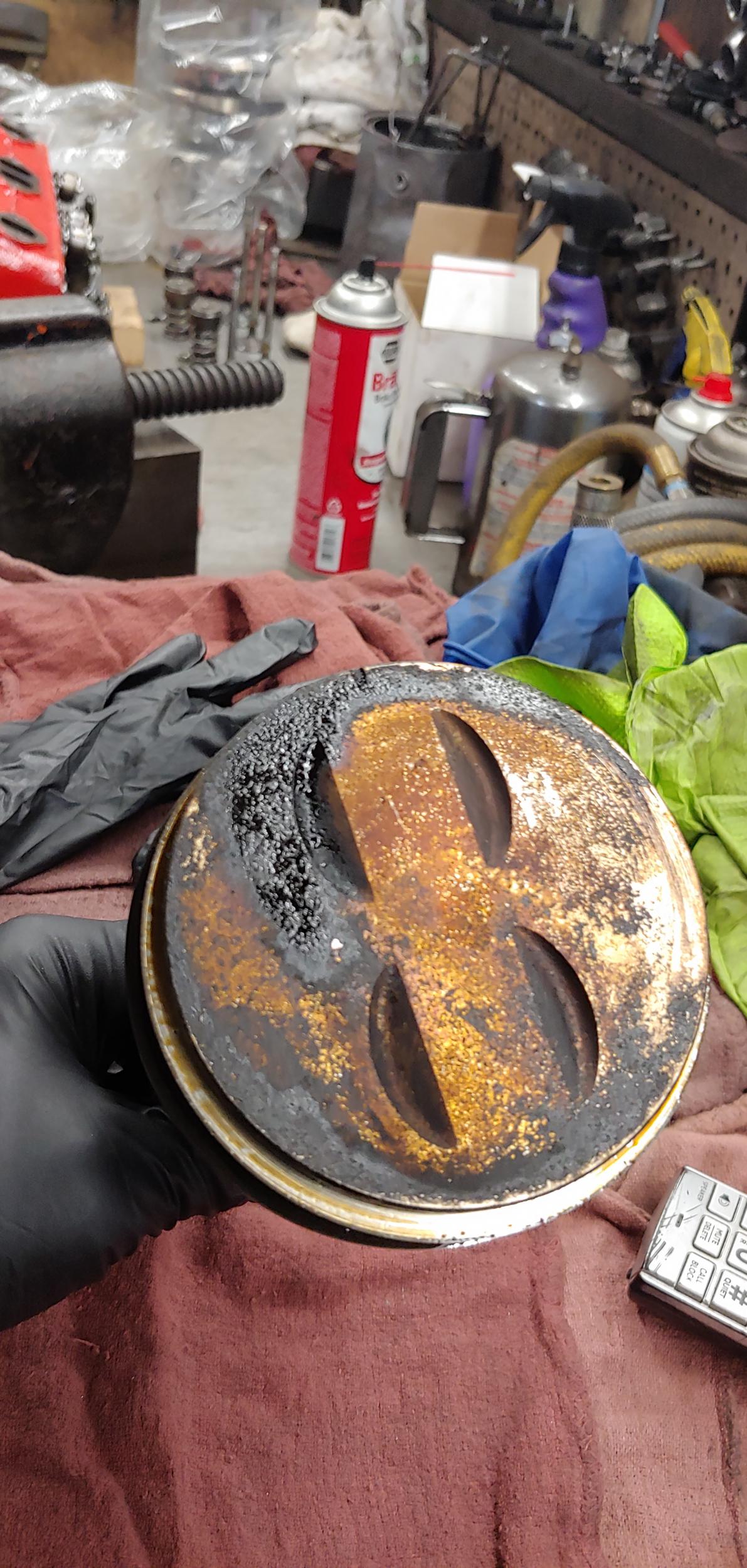

This is a stock rebuild of a 250hp 327 (owned by a friend). The engine only has 100mi on it and it was pulled due to a severe vibration. I can see that the exhaust valves show signs of over heating, but I'm not sure what the deposits are on the pistons. Maybe it's running so lean that it's melting the aluminum? He says the plugs are "clean". He was using Sta-Bil in the gas.
Any ideas anyone? Verne |

The vibration might have been severe detonation, but that should have cracked the ceramic in the plugs. It does look lean, but I'm no expert.
Did it do it after the rebuild or after a few miles? |

Right now my question is what caused the appearance on the piston?? The mechanic says the problem is the gas and the carb and that's why he was referred to me. But I disagree that a carb problem would cause a vibration. Maybe a miss or hesitation, but not an actual vibration. I'll be speaking with him later for more info. Verne He just sent this pic of a plug. They all look like this and they look fine to me. Last edited by Verne_Frantz; 12-18-2020 at 02:56 PM. |

WOW those valves look overheated. Piston looks like cooked on oil - a flat top in a 250 hp 327 hard to believe there were detonation.

The black stuff looks like deposits from octane booster. You wouldn't think it would need octane booster with flat tops. Can't imagine he put enough Sta-bil in there to cause deposits.
