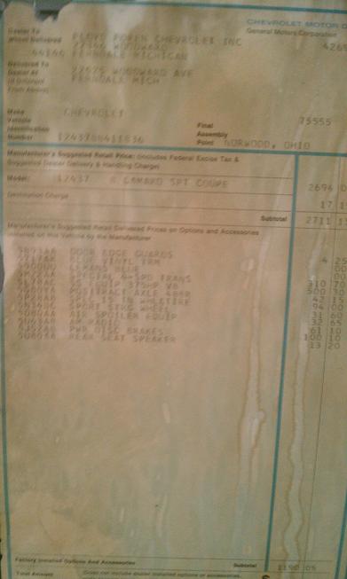

Hey guys, i just bought an original paint, 1968 camaro ss 396/375hp 18,000k miles. m22, with factory 4.88 gears. The original motor was blown up in the day and switched out the block with a 69. How can i identify this car is a real l78 car? It still has the original window sticker (i believe) stuck to the dr side glass. It looks super vintage, options including a 375hp engine and 4.88 ratio rear end. If anyone can help identifying this car, let me know. THANKS!!!!

The window sticker is as clear as mud. Need a better pic.

half of it, im having trouble getting pics small enough to load..

Looks like a repro window sticker to me. the last six of the vin are usually stamped in ink on the window stickers Arent they???

Usually, not all. I have jerrys z28 book and shows an original identical to mine.

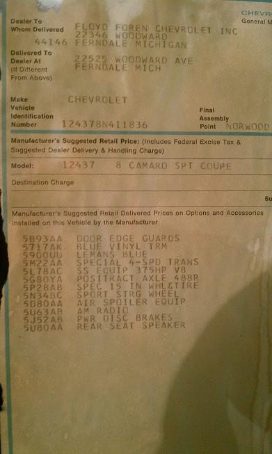

The w/s is real. The non-typed VIN indicates it was re-printed at Norwood according to a friend who was a dealer. The original either had an error or the car had been cancelled and assigned to another dealer.
No one noticed "P28AB SPEC 15 IN WHEEL&TIRE?" Never heard of that option.

I don't see the P28 15" wheel option on any option lists. Its a good research subject. Anyone hear of this?

It's a Vietnam car, the guy ordered it and went into army. The car took 6 months to order and it was used to street race. It had a hone o drive in it before I got it

Is the tire size and inflation sticker still on the inside of the glovebox door? if it is, what does it say and can you show a photo? this could be monumental!
