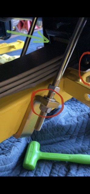

Once I got everything bolted up, I noticed there was a severe front to back “rock” on the differential despite all the bolts being tightened (see red circles in picture). It appeared as if the wedge created a gap 1/4” between the front spring perch insulator and spring (see green arrow on picture).
My question is, do I install the lower insulator with the wedge? If not, how to I remedy this front and back motion?
My assumption is that the lower insulator must be installed, I just couldn’t see how the assembly would stay “located” with the alignment pin from the lower portion of the leaf through the insulator, wedge, and down into the traction bar hole.

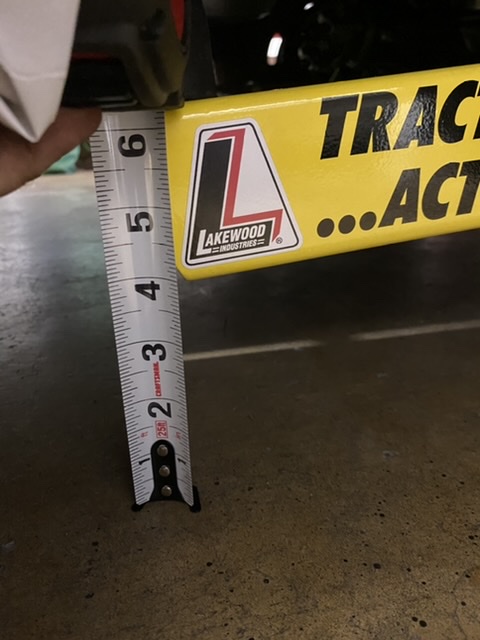

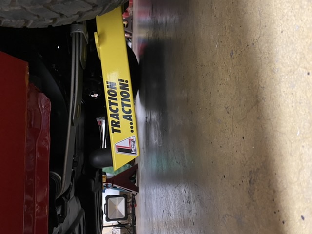

I decided to bolt it together, without the wedges, utilizing the lower spring insulator and it worked great. Unfortunately, this manner of installation isn’t possible because the bars hang far too low to the ground (see picture) and have a tremendous amount of gap between the snubber and the leaf. My understanding is that 1/2” gap is the max you should run.
