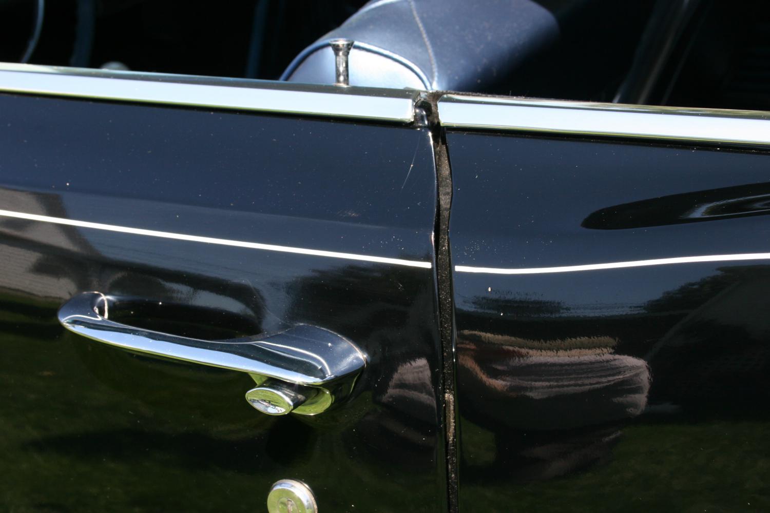

The pinstripes on a GTO or 2+2 were first offered in 1965. The base model cars did not offer the factory stripes.
You were allowed to delete the pinstripe at the buyers request by writing across your new order form, “Do Not Apply Paint Stripes”.
The very early build ‘65 cars (Aug./Sept.‘64) had the pinstripe applied by hand.
Member Keith Seymore Sept. build GTO is a perfect rare example, Original Black body with hand painted Red pinstripes.
One can only imagine the labor involved with this hand application.

Hand painted pinstripes shown on Mr. Seymore’s ‘65, Pontiac plant build (09A).

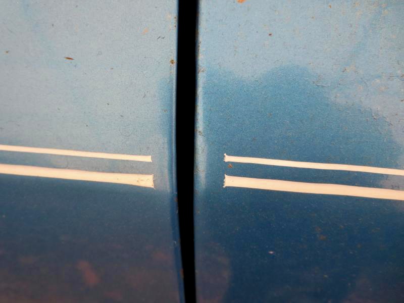

This ‘66 GTO was built at the Fremont plant (01B).
Cameo Ivory with Red stripes.
As I mentioned earlier, the application varied from plant to plant.
Obviously they used a wider tape at the seams which allowed for a wider gap in the stripe.
Notice the “ribbed paint wheel marks” and the paint bleed out at the tape in the last photo.
I doubt you see this on a high end restoration.
Survivors are the best, an encyclopedia.

Here are a couple ‘67 GTO’s with their factory stripes.
You can really see where that tape was allowing the paint to bleed out.
Also the Beugler wheel marks in the last photo, top stripe.
Factory stuff.
