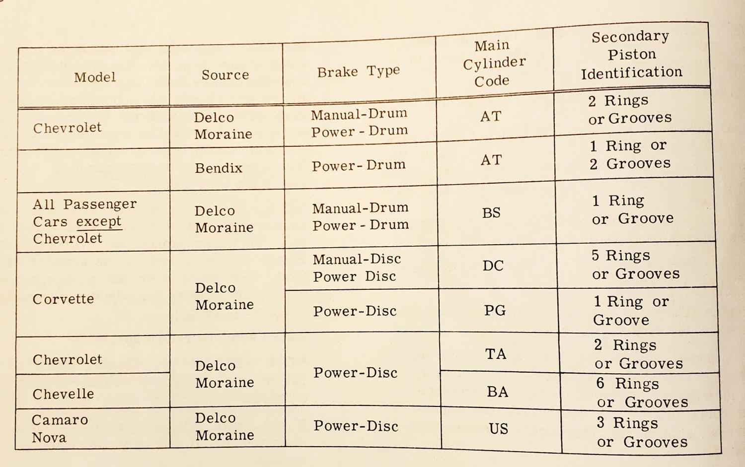

REF: 1969 CHASSIS SERVICE MANUAL
Page BRAKES 5-16
Brake Main Cylinder Identification (Chart)
69 Los Z11
68 SS/RS 396/325
68 Los Z28

BigD69 BigD69 is offline
Join Date: Feb 2017
Location: Ohio
Posts: 236
Thanks: 26
Thanked 24 Times in 12 Posts
Default Master Codes
Here is a pic from the 1969 Chassis Service Manual.
