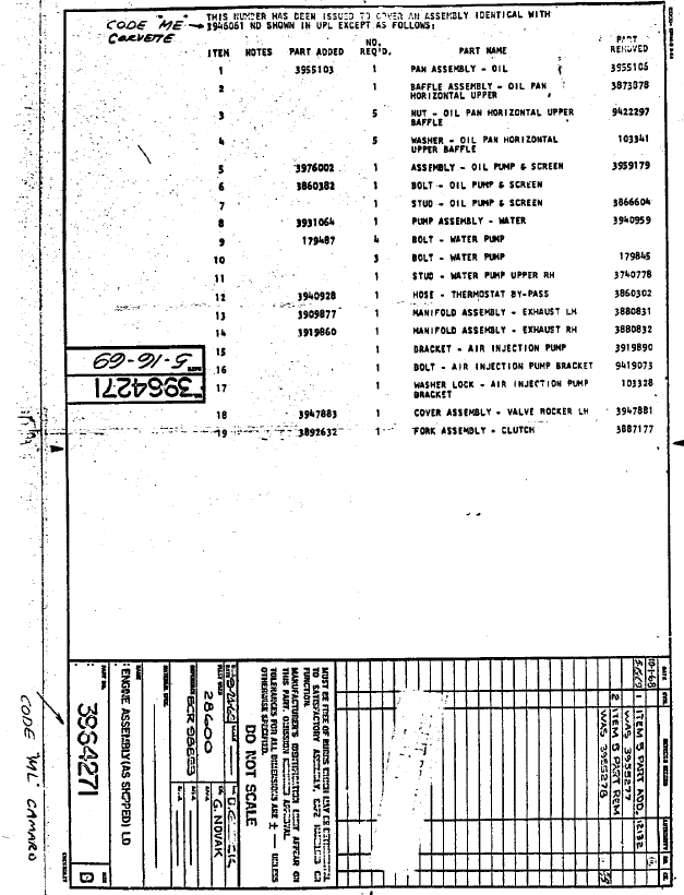

It seems that there are more 3946052 ZL1 blocks popping up on ebay every day. From what I understood there were only 69 camaro's and 2 corvette,s and maybe 18 or so over the counter motors. And how do you tell if it is a over the counter motor from one that came in a car from a can am motor? I own one that doesnt have any dates or vin #'s on it, just a cast number. Mine came from Washington state and has a history of being in that state for at least 25-30 years or so.

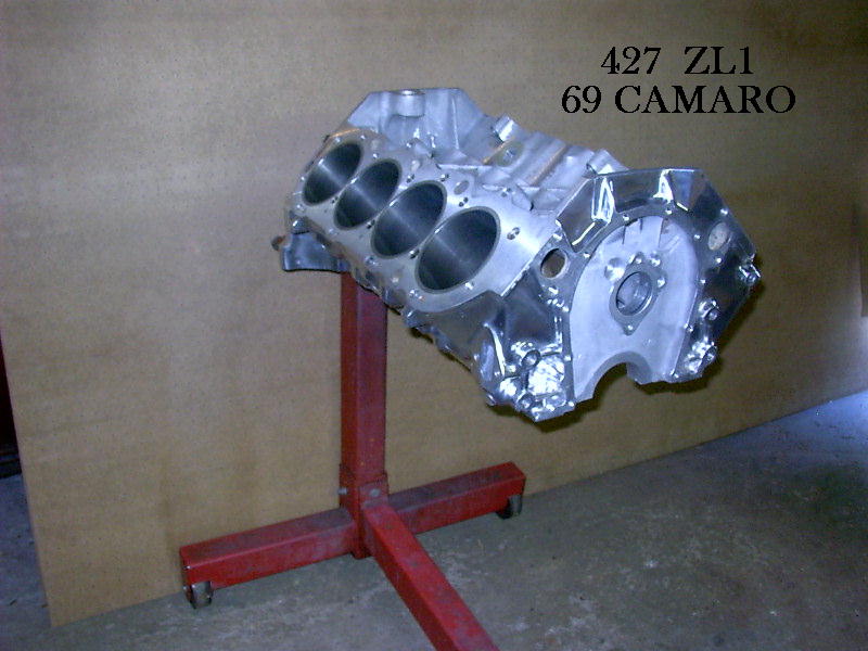

Thanked 99 Times in 28 Posts
Default Re: how many zl1 motors were made
I do have one of those new blocks. I built a complete ZL-1 engine with ZL-1 heads,manifold,carb,distributor, and NOS Zl-1 cam,pistons,crank,rods,etc. and run it in my 69 SS Camaro. The block is outstanding quality, the engine is the same weight as a small block. The new block has the early ZL-1 casting number 3946053 and no "Winters" snowflake on the front.

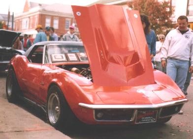

I know a guy that has 7 of the original ZL-1's. One is out of his 4000 mile orange ZL-1 Vette and the other 6 were over the counter
