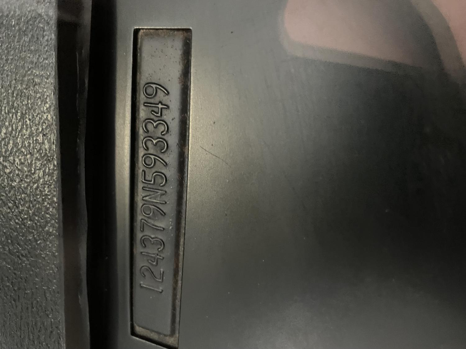

Hi Guys,
I have a friend from work who's husband recently passed away. He had just purchased what looks to be freshly restored 1969 Yenko Camaro. The VIN # is 124379N593349, Color is blue w/ white stripes, Aluminum Yenko cast 427, 4 speed transmission, front disc brakes. I am trying to verify the car for her to see if it is a true Yenko or a tribute? I have had no luck with the Vin in any registries that I have found? Any back round on this would be greatly appreciated.
Thank you, Steve
Adding a few pic i took of the tags off the car and added the 1 to the VIN.

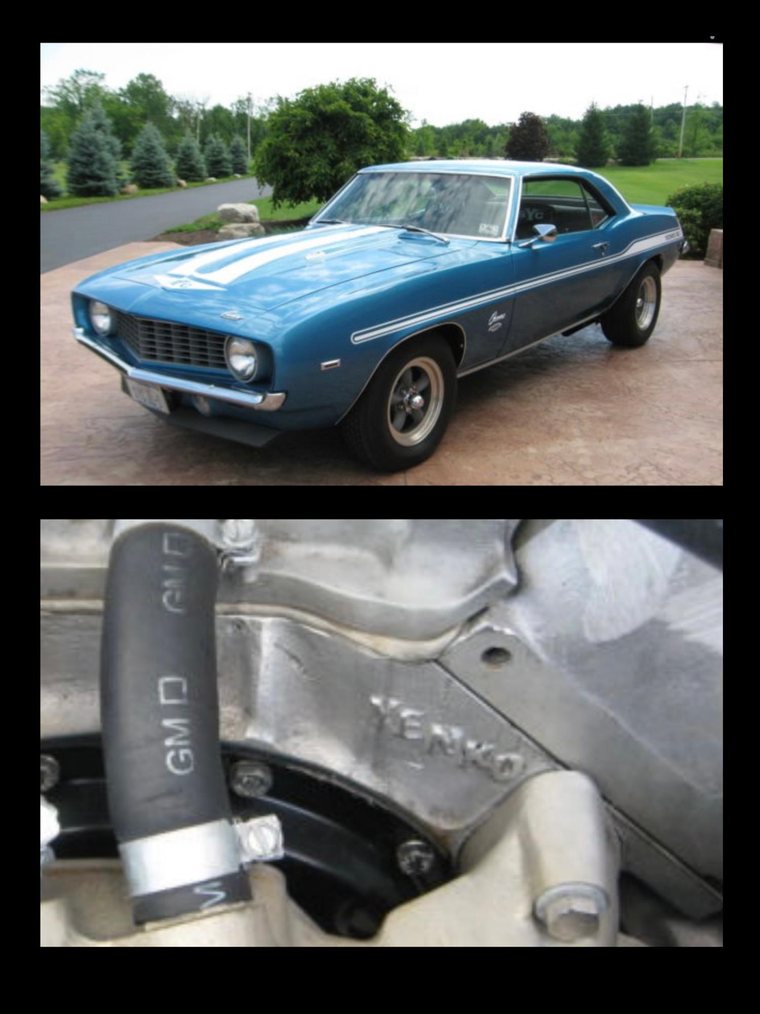

Old 12-31-2023, 03:17 PM
Posts: 12,393
Thanks: 18,642
Thanked 5,671 Times in 2,415 Posts
Googling VIN w/ missing 1 added 124379N593349 shows it for sale as a Replica/Clone/Tribute, here’s one link..
https://veh-markets.com/cars/chevrol...ine-video.html:
Seems familiar w/ Yenko ZL1, have we looked at this one here before?
Chevrolet Camaro 1969 technical specifications
Item location: Albany, New York, United States
Make: Chevrolet
Model: Camaro
SubModel: Yenko ZL-1 427
Type: Coupe
Trim: Replica Clone
Doors: 2
Year: 1969
Mileage: 2,776
VIN: 124379N593349
Color: Blue
Engine size: Yenko ZL-1 427
Number of cylinders: 8
Fuel: Gas
Transmission: Manual
Drive type: Rear wheel drive
Interior color: Black
Vehicle Title: Clear
Seller Contact 518-928-4172
The Following 2 Users Say Thank You to PeteLeathersac For This Useful Post:
69M22Z (01-01-2024), John (01-01-2024)

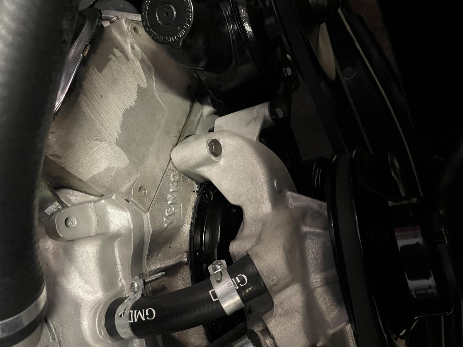

Old 01-01-2024, 07:25 PM
Steveb Steveb is offline
Join Date: Dec 2023
Posts: 3
Thanked 2 Times in 1 Post
Default Yenko engine
Hey Pete,
I posted a few picks I took of the camaro and if you compare the pics of the front of the Yenco engine. The clamp screws on the bypass hose are different?
Maybe not the same car? I beleive the car was purchased through Joe Verrillo out of New York. I'm going to try and contact him this week.
Steve

Old 01-02-2024, 11:59 AM
big gear head's Avatar
Join Date: Mar 2012
Location: KY
Posts: 3,386
Thanks: 5,701
Thanked 1,479 Times in 767 Posts
Originally Posted by Steveb View Post
Hey Pete,
Steve
It's the same. The same casting flaw on the front of the block, the same grind marks on the end of the head. The intake has been off and reinstalled, so the clamp might have been changed at that time.
Freddie
