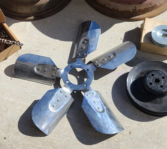

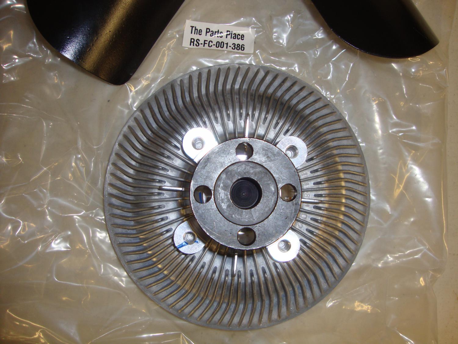

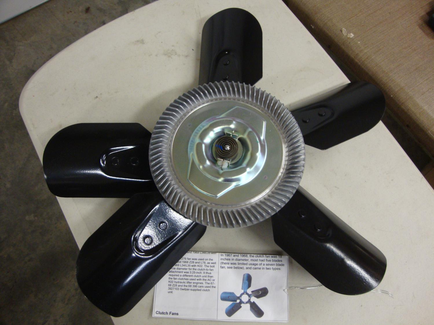

Technical Inquiry:
Looking for a new functional fan clutch that will bolt up to my L78 fan with 3.25" bolt pattern.
Can't afford an original clutch right now but I'd like to run the correct fan.
I can't seem to find one with a 3.25" bolt pattern. Anyone?
Jose Betancourt
67 Camaro L78
Attachments - The Supercar Registry L78Fan.jpg Hayden2713.jpg DSC04122.jpg DSC04121.jpg

What about Vette Suppliers?
https://www.paragoncorvette.com/sear...erm=fan+clutch
They do not disclose the fan mounting stud bolt circle dimensions= Dang it
I am in a similar situation Needing a 3927103 (or suitable replacement), 5/8 pilot hub w/ 1-3/4

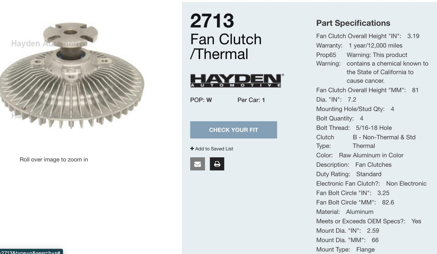

I'm going to give Hayden Part 2713 a shot as it does have a 3.25" bolt circle.

What do you think of the "Heavy Duty" <3.5"BC>
Brand:Hayden
Part Number: 2747 2947

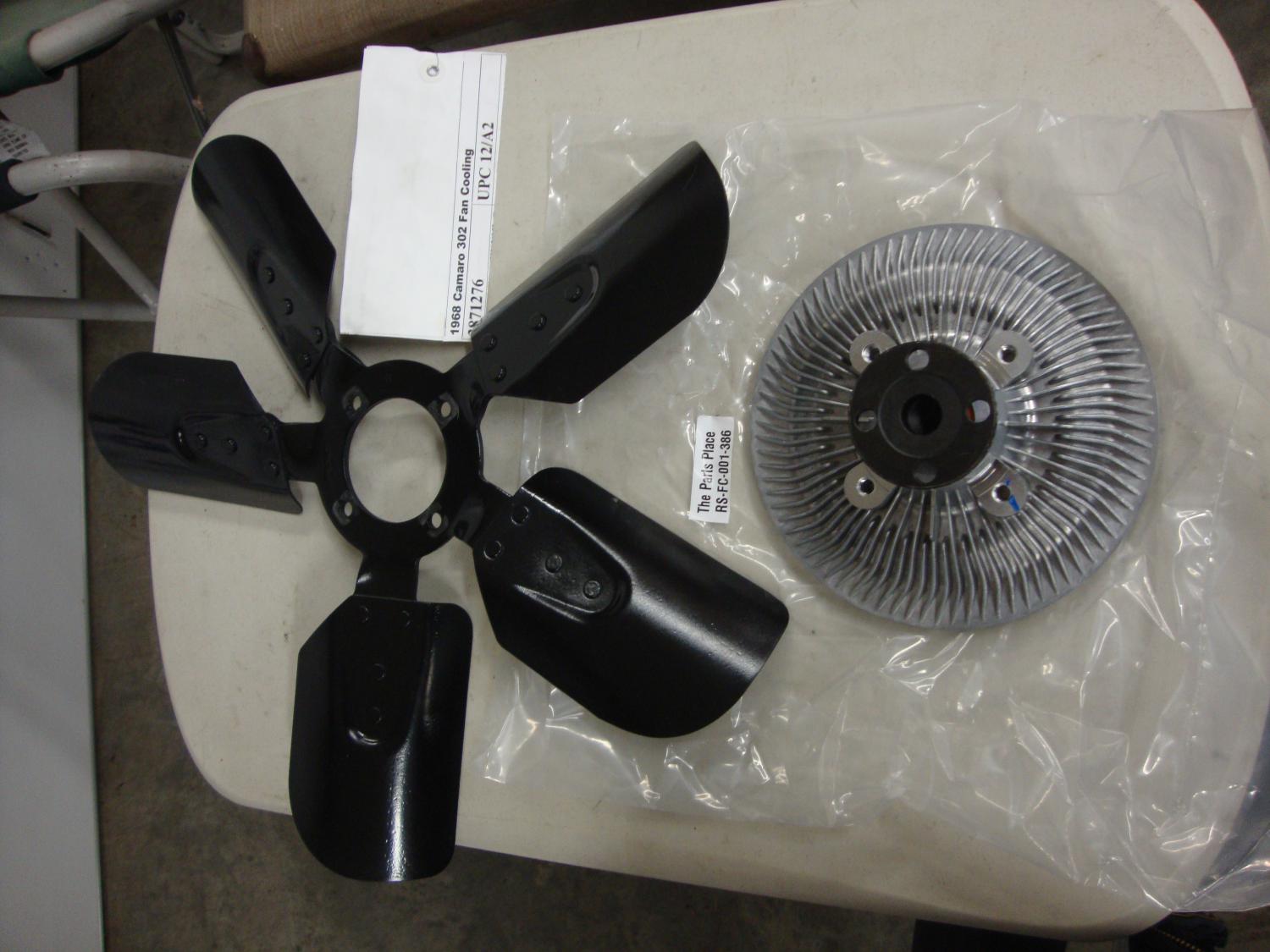

The Part Place
TPP #: CS1386Z

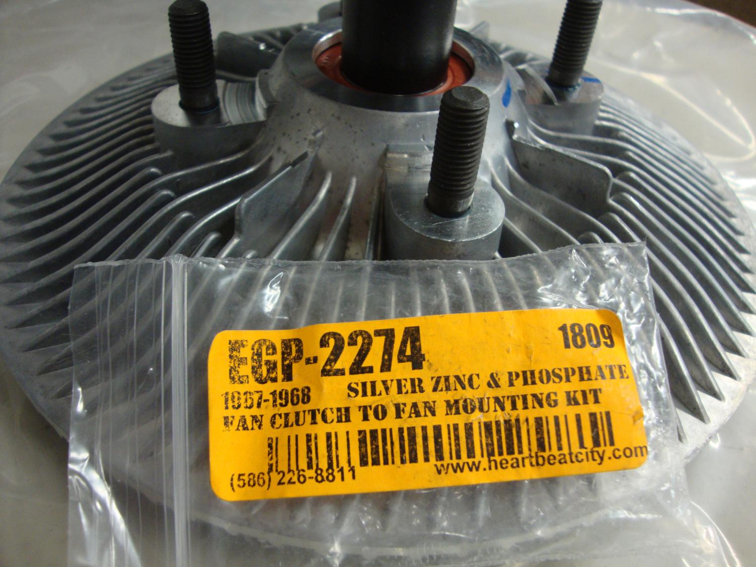

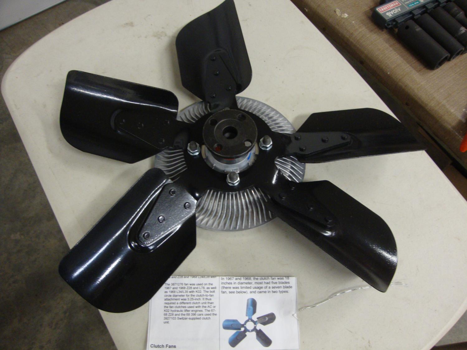

Default Replacement Clutch
I purchased this and it fits very well & will report how it functions when I lite off and run the motor and car. This is used with a Factory Solid Lifter Fan. While the replacement lacks the appearance of the GM Clutch, it should fit the bill as an economical temporary replacement for those seeking the rare orig clutch.
Link
https://www.ebay.com/itm/35195350436...Bk9SR461moGVYQ
