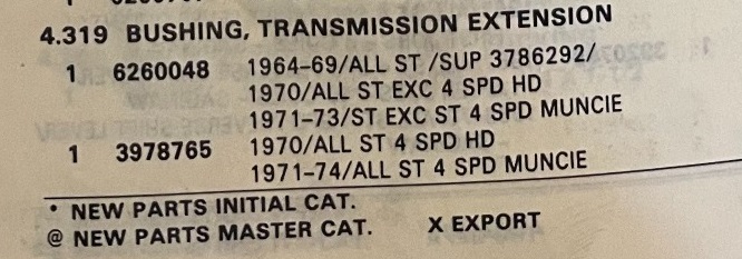

Is a 70 m22 tailshaft bushing the same as a th400 bushing

Default extension housing bushing
Spare gm bushing i have from long ago, probably not the same as turbo 400 has different part number 8626901.

Different o.d. M22 2.010 , o.d. 400 1.995 . Inside diameter the same , different bushing . Transtar part # for M22 is 331066 if that helps . Call Ed at (610) 623 - 9381 he specializes in muncies .
Are you doubting GM part #s out of the product info program book.

That is Transtar part # not gm .
Who holds more merrit GM ac delco (8626901) or transtar IM always inclined to learn. thanks Marc.

Same as Auto Zone has different part # than GM , different companies different part #s .
