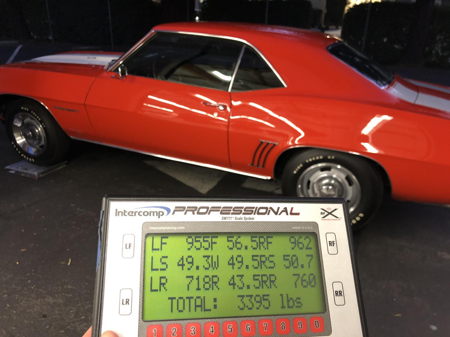

As one reference, here is my stock ‘69 RS Z/28, steel cowl hood, spoilers, console, and a full tank of fuel - 3395 lbs.
