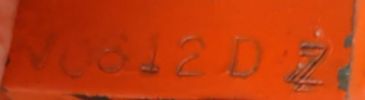

https://www.hemmings.com/listing/196...-camaro-601220
124379N668823
From the ad:
"The original 302 which is not currently in the car coded 3970010(v0612DZ) is included with the car."
Here's the pad.

Old 07-19-2023, 05:16 PM
big gear head's Avatar
Join Date: Mar 2012
Location: KY
Posts: 3,383
Thanks: 5,661
Isn't that block a later model truck block with the narrow pad? Not even close to being the right block.
You are correct, the 1977 and later blocks all had the small pad, I call them the lightweight blocks as lots of metal was romoved to save cost.
