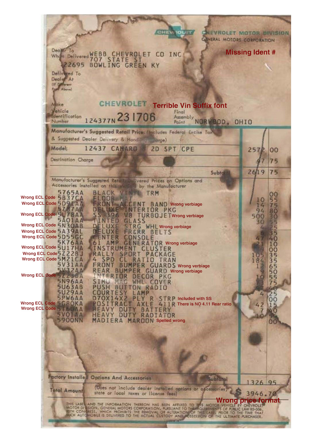

This 1967 Camaro is currently at Kissimmee, advertised as an original window sticker. Takes a lot more than aging to reproduce a window sticker correctly........

POP looks like of fresh too?

Vin 124377n231706

Other than the steering wheel cover... lol...and the (very) bad window sticker, I really like the car. It has a nice stance, no doubt owing to the Ridetech components. You couldn't build that car for that price.
