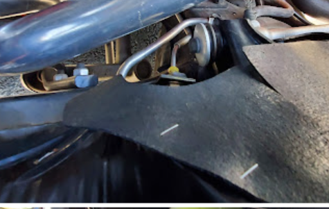

Beautiful car about the holy grail of 69 Z-28's, too bad it looks like the trim tag is fake....

Old 08-21-2024, 05:23 PM
Posts: 20,896
His upside down/inside out cowl seal too........again.

No 302 emblem missing from the cowl hood? I thought all cowl hood Z's had the 302 emblem.

Posts: 2,648
Thanks: 252
They did.
Has a shopping list of issues, the splash seals crack me up!

Chinese booster too.

This car is local to me. A friend asked me to inspect the car 3 +years ago and several owners. I spent 5 minutes and said I've seen enough Nick don't even consider this car. Just a put together train wreck....

Not even a good fake.

All those yellow inspection marks!!! I just hate when people just make stuff up.

Reproduction cowl tag
