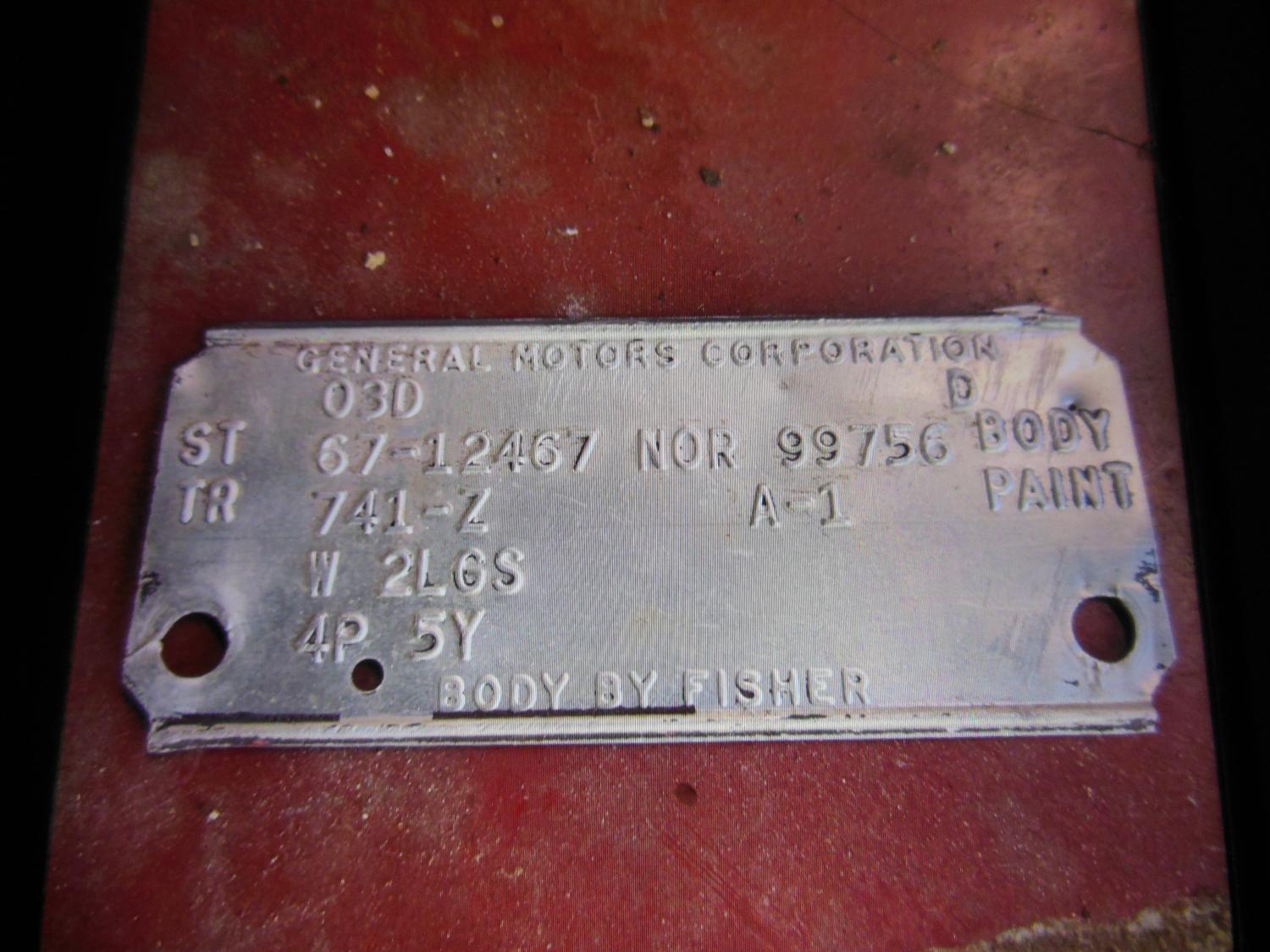

Can someone decode this 67 camaro tag thanks it does have a 12 bolt with the factory tracton bar

The fun part about discovery lies here, courtesy of CRG.
http://www.camaros.org/numbers.shtml
http://www.camaros.org/radiusrod.shtml

What size fuel line is on it?
Does it have a small block heater core or big block?
Does it have a tach? If so what is the redline?

Its a smallblock 4 speed convertable no tach

Black with white top and red interior, but I suspect you knew that.

Ya just not sure on all the other codes

G - Console
L - 4-speed
S - Rear manual antenna
P - SS 350 (with some exceptions)
Y - Deluxe belts

i am assuming this is a desirable camaro it is a project not a totlal rust bomb non original engine and trans

IMO, by the TT having been removed it will always be suspect as to being the real deal.
