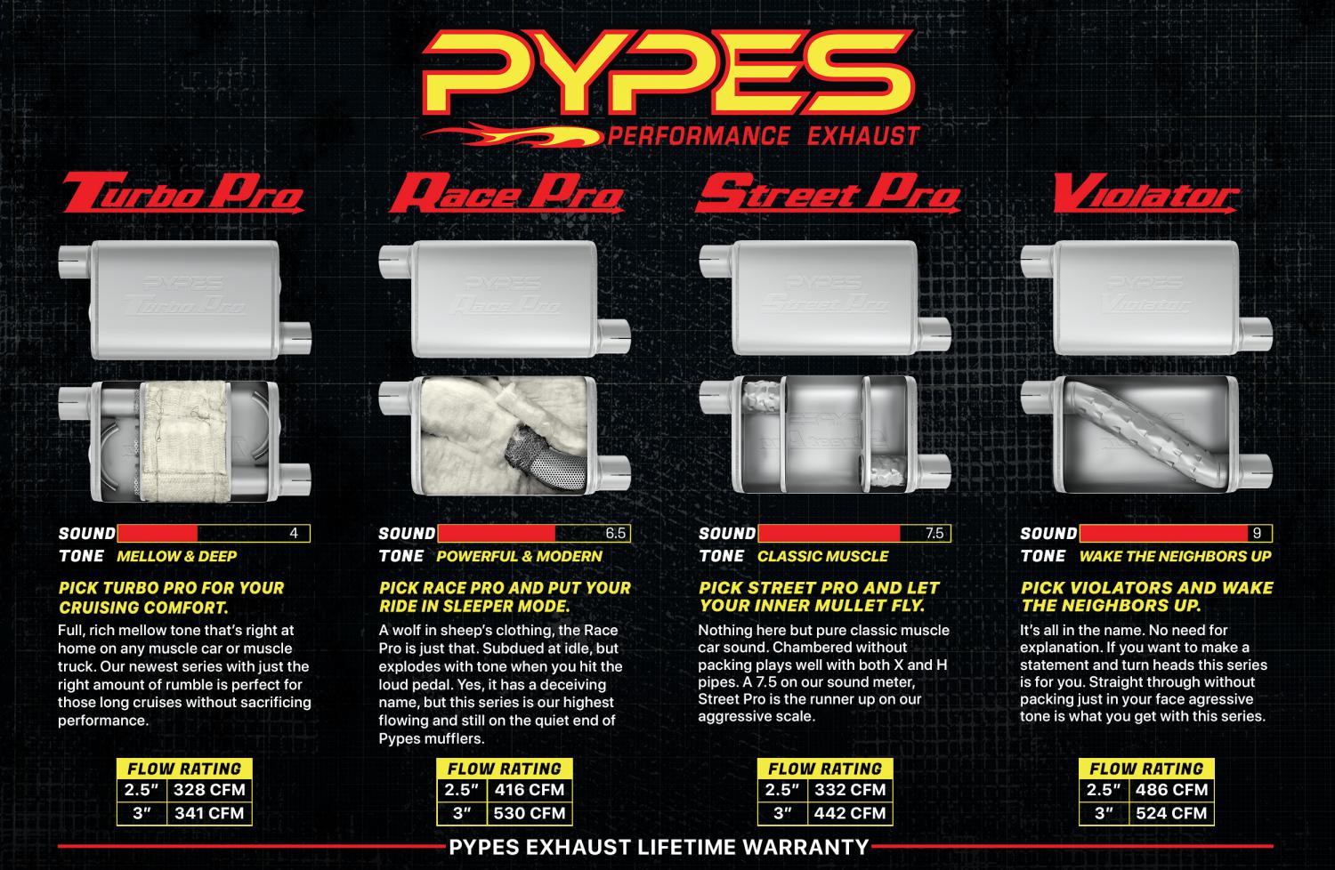

Hi Guys,
I'm helping a friend spec a protouring car and after driving a comparable model, he mentioned it is too loud for him/family. Does anyone have experience refining and quieting an exhaust system?
The car is running a new coyote Ford crate engine. It will be used a weekend cruiser/never raced. Performance loss is not a concern and likely won't be noticed.
I'm considering a couple baffles and muffler combination but would appreciate feedback on type/style/brand.
Thanks,

I'm a big fan of the Pypes "Race Pro" that I have on my LS swapped Chevelle. Very smooth sound, no drone, 3" with X-pipe, and dumps before the rear axle.
LS engines don't have quite the shriek of a Coyote, though.

I have Race Pro's on my Camaro and they are about as quiet as I want for normal driving. Step on the pedal hard and they are going to let everyone in a wider area know that the car is around...

X2 on the Pypes Race Flow. Have had it on a stock L78 Nova for years, I use the Transverse Muffler mounted in the stock location and configuration. it is really pretty quiet at idle and normal driving, but jump on it, and it roars. Best of both worlds IMO
