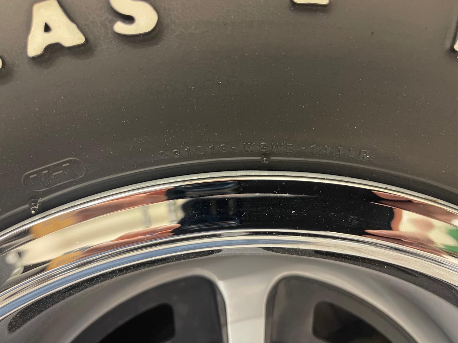

I am attaching a couple of pics of some repro Goodyear tires to see if this is enough information for anyone to say what the date of manufacture is. Not sure if these are the right numbers to be looking at? I hope these pics are not giant!
Thanks.

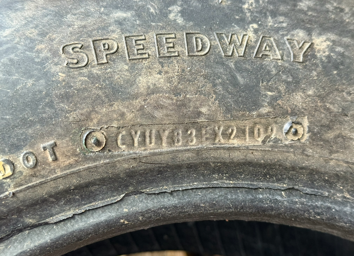

On mine the stamp is on the inner sidewall, next to the “DOT”. I believe the last 4 digits are the date, with the first two as the week and the last two as the year. So on my old ones 2109 means 21st week of 2009.

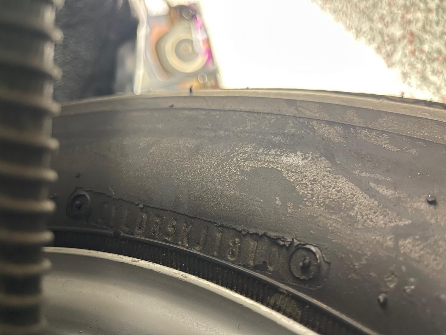

Here is the set of letters/numbers that should be the ones. Appears to be CYLD8SKJ1810…

The numbers can be difficult to see, so use a high powered flashlight to get a good camera shot. Turning the front tires will do you good.
So it looks like 18th week of 2010
Thanks Matt. Well that sucks, I guess they will look good standing still, as I don’t think I want to drive on them. 😳
