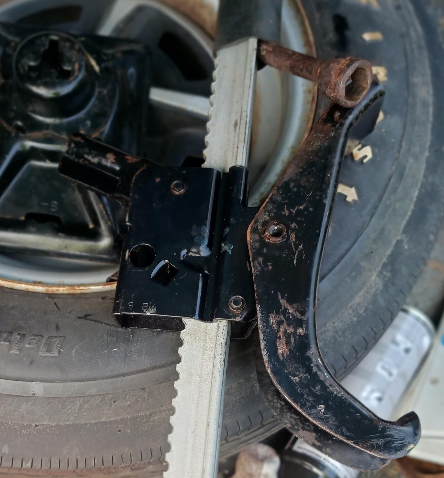

Looking for 68 Jack Handle - however, not sure of the correct dimensions
Length to the angle, angle to the lug head, degree of the angle @, should it have an 'O" ??
Or if you have one, let me know......lots of different ones out there!

Is yours LA or Norwood?....Joe

norwood

March 69 Baltimore Chevelle does.
Feb 69 jack.
New condition spare with all 5 wheels dated 1 6 9.
Sorry if TMI but all was there in her car.

I would search for a handle that has the raised letter "O". The length to the angle should be 16 1/8" and 18" from the tip end of the handle to the socket end of the handle. The angle to the socket end length should be 4 7/8". I know what you mean when you say lots of different handles. I am sure GM had a few suppliers.

I have one that matches those dimensions if needed.

Big shout out to Mike Mytro for the dimensions and to Larry (lbnaz) for providing the correct Jack Handle..........
Much appreciated Mike and Larry!!!
