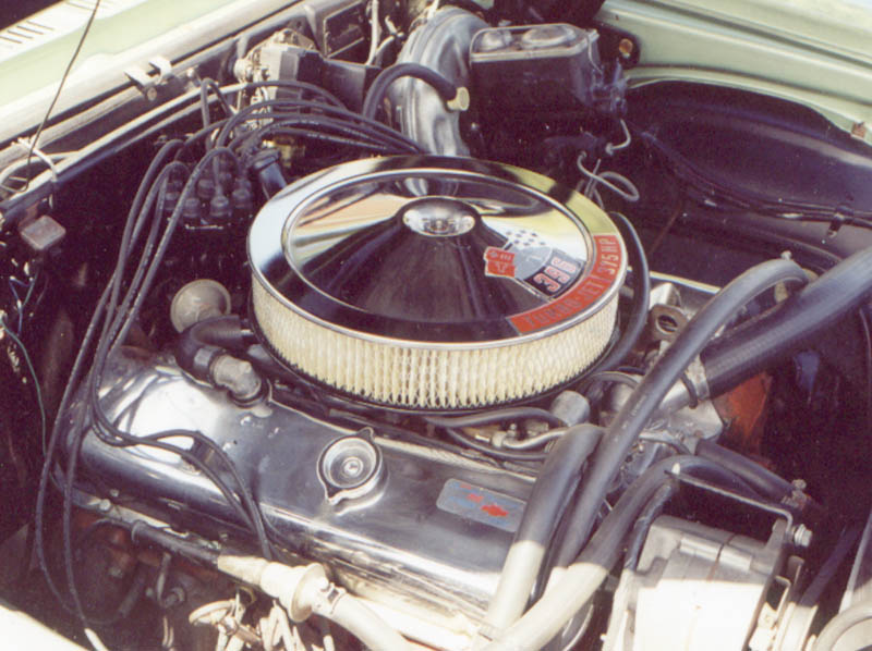

I still have the idea that you could make the repro 69 air cleaner base fit by twisting the crankcase vent tube to the rear. In case it helps, this is what it should look like.
