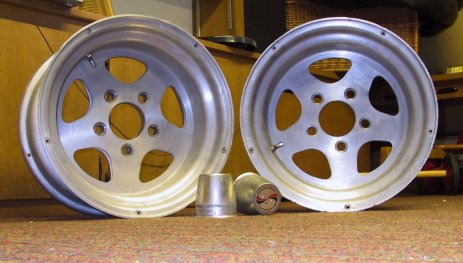

Well, I went ahead and bought them tonight...and now I just read all these replies and I'm thrilled to hear that these are the Red Alert wheels. These will be going on my much less famous '70 Chevelle SS396. The seller only had two wheels, both 15x8 with the Chevy bolt pattern. These are the aluminum wheels with the floating spacer. They are super light and pretty cool looking. Unfortunately, the lug nuts were long gone and it looks like they're supposed to be some kind of extended shank design with a flat washer.
The lip of each rim is a little nicked up and the finish is oxidized. Has anybody found a safe, mild cleaner to use that won't affect the surface?
Thanks in advance,
Tony

Post a picture Tony.....

Tony,
------Good for you.Glad you got them.You are correct in your lug-nut assesment.The problem is that the hole is larger than any nut you are going to find out there.I had some sleeves machined up that slipped over any currently available shank style lug-nut.Make sure what ever nuts you buy,that they extend almost all the way thru the wheel.Also dont over torque these wheels as the spacer is aluminum as well and you can damage them.Ive got the torque figure written down somewhere,but cant lay my hands on it.Maybe another member can give us a good figure.
------Good luck trying to find another pair.Ill keep my eyes open for you.......Bill S.......ol red!
------P.S....Make sure you take a good long look at your wheels,as they were manufactured for drag-racing only.Any small fissures around the bolt holes,or anywhere for that matter would give me pause as to using them!

I took a couple of pictures today. These wheels don't look like they were really abused, just weathered. The seller's story is that they were on a '64 Nova drag car from Florida that had been campaigned in the '70s and had sat since 1979. Chrome on the center caps is pretty much gone but the color on the medallions is nice.
