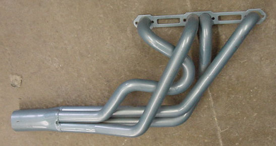

Does anyone have a picture or description of what factory headers look like? I just picked up a Z that has headers with 4 bolt collectors and 3 piece flanges.
Thanks,
Jason
Attachments - The Supercar Registry 65103-Kustom Camaro headers KH37.jpg 65006-Factory header RH, Thomas style.jpg 65005-Factory header LH, Thomas style.jpg

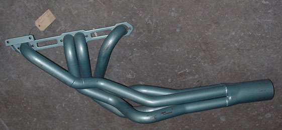

Default Re: Factory Z28 headers
According to Jerry's book, the factory headers were built by Thomas and Kustom. Both had flanges that were connected, not 3 part like you describe. The Kustom headers had 4 bolt collectors, the Thomas headers were slip fit and then 3 bolt collector. Here's some pictures of the headers I had Stahl make for me to somewhat duplicate the factory headers.

This is what an NOS set of factory headers looks like. This is the driver's side Bill Thomas style used in '67. Stahl headers do not have the same pipe bends as these but use the same (or similar) style of flange at the cylinder head interface.
-Jon
