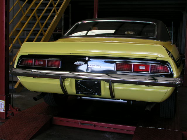

Old 01-08-2004, 03:58 PM
Location: Woodland, ca. US
Posts: 15,963
Thanks: 482
Thanked 4,706 Times in 1,208 Posts
Default Re: Black Tail Light Panel and Rockers
Nope..I gotta disagree. Here is my 7000 mile Yenko and it is gloss even around the weatherstrip.

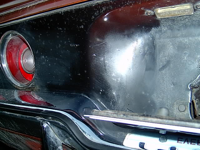

Old 01-08-2004, 09:58 PM
Posts: 2,636
Thanks: 104
Thanked 173 Times in 78 Posts
Charley, Curious if your Yenko that you attached picture of is the former BKH car or only similar in Color......I have picture of the former BKH Yenko showing very glossy tailpan.
Also observed Joe S 69 Harrell car at Vette Fest / Noc 03 with GLOSS tail pan......My mostly original paint 70 L-78 Camaro shows Black paint tailpanel (attached) underlicense plate quite glossy....I hope somebody, someway can justify our allegations with paint company documentation.......Chuck S
