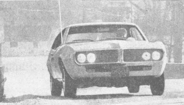

I'am starting with the rare Quebec only 1969 Firebird Comanche
Anyone have more info/photo on this rare Bird.
Firebird Comanche
Attachments - The Supercar Registry 67882-bluebird.jpg 66896-67FitchBirdTest2A.jpg 66895-67FitchBirdTest1A.jpg 66833-67FitchBirdTestS.jpg
