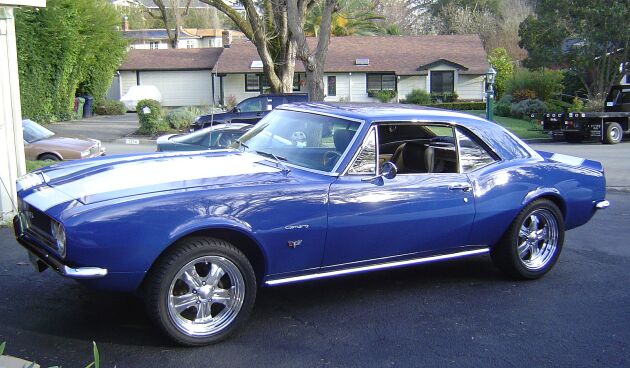

[/ QUOTE ]Of course I was being facetious. This is our "plain Jane" we're currently working on.
Jeff
