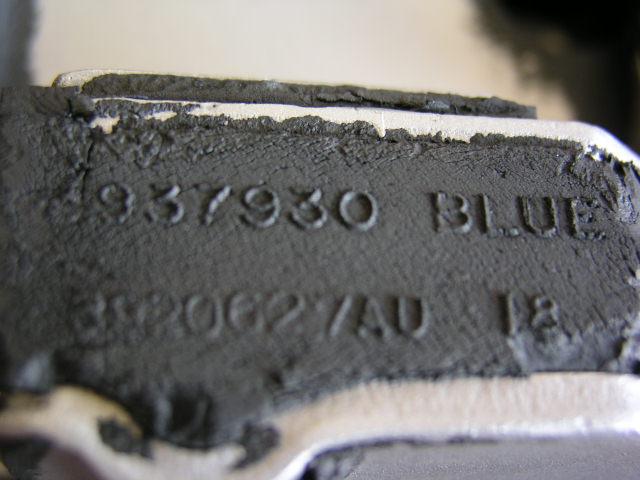

Old 10-16-2004, 09:52 AM
Location: Woodland, ca. US
Posts: 15,981
Thanks: 495
Thanked 4,775 Times in 1,222 Posts
Default Re: Correct big block engine mounts for 1969
I have one that I will look for tomorrow to get you a pic.

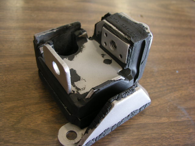

Old 10-17-2004, 02:54 AM
Posts: 15,981
Thanks: 495
Here you go.

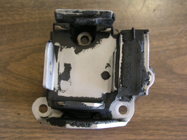

Old 10-17-2004, 02:56 AM
Posts: 15,981
Thanks: 495
another view
Old 10-17-2004, 02:57 AM
Posts: 15,981
Thanks: 495
Part #
Old 10-17-2004, 07:01 AM
nuch_ss396 nuch_ss396 is offline
Join Date: Oct 2004
Location: Western North Carolina
Posts: 1,713
Charley,
The pictures are absolutely awesome!
