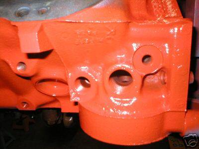

I thought 2-bolt blocks had 1 fitting for the oil sender
and 4-bolt blocks had one hole for the sender and a second larger hole for the oil cooler line fitting. I will try to find a picture to post. Eric |
Thanks for the replys. Eric, I will call you shortly. The block has 2 holes by the filter. The one directly above the oil filter is larger that the one that is off to the side.
James
1968 Beaumont SD396 |
Sounds like a 4-bolt block
Jake is my grandson!! |
Aren't those bosses routinely drilled on conversions?
Could this be a picture of one.
