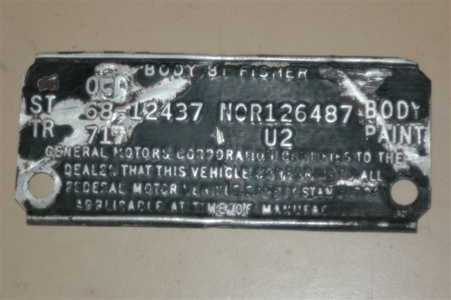

I know squat about Camaros.. so can one tell if a car is a real 69Z by the trim tag or VIn or motor stamp??

Looks like tag is for a 1968 8 cly Camaro. '68 tag will not designate V8-engine option.

Decode for body number: 126487
05A = Built the First week of May. (assuming 5A, hard to read)
68-12437 = Coupe.
NOR = Built in Norwood Ohio.
717 = Standard Blue Bucket Seats.
U-2 = Lower Color is LeMans Blue and the Vinyl Top Color is Black.

I'm sorry, Yes, I meant to say 68 Camaro. How does one tell a real 68 Z-28? in absence of build sheet/docs. Has orig engine and trans, all numbers that seem to match up date wise, etc
Thanks Denis/Stefano
