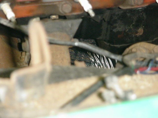

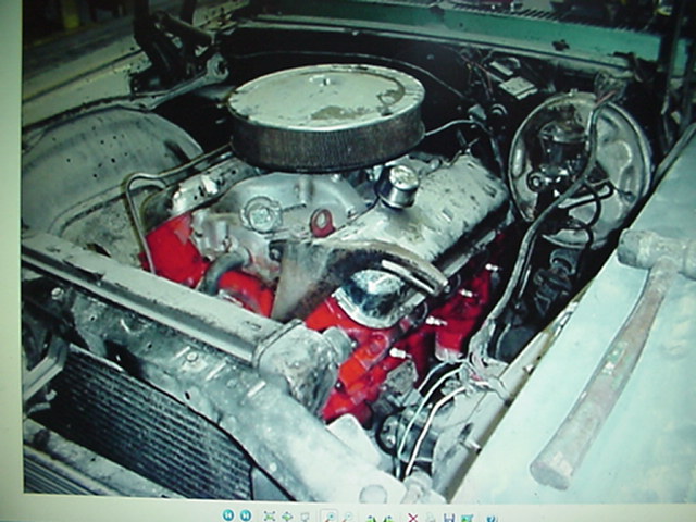

Thanked 30 Times in 18 Posts
Default Re: One for the eBay record books
pic of org motor
Jake is my grandson!!
You guys must not of had your tongue just right because here is picture with the motor in with the same oil pan. The first picture was taken just before I dropped the motor in.
