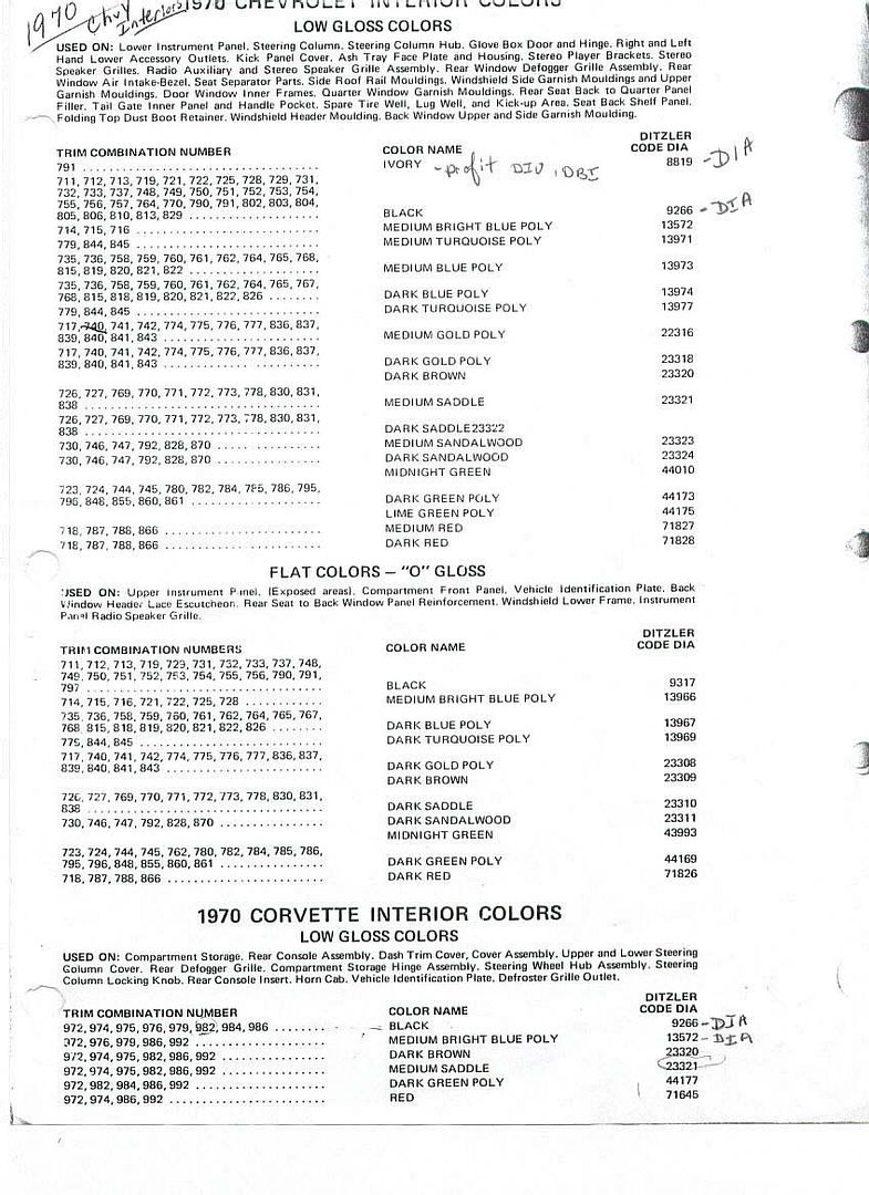

Here is 1970 PPG Interior Colors, which I would THIMK is same as 69, at least the Blacks....Hope this is of help???

For these specific 1969 interior 711 &amp; 712 areas:
*Upper Instrument Panel
*Radio Aux Speaker Grille
*Rear Window Defogger Grille
*Back Window Lower Garnish
They suggest using Fisher #W0A848,or Rinshed-Mason Tintometer #168C41,
then adding Alpha-Cryl formula No.849 Suede Concentrate to produce a Zero gloss finish.
I have a jobber here who mixed some of this for me recently.

Those codes are from the 1969 Chevrolet R-M Paint catalog.
Alpha-Cryl #849 is an R-M flattening agent.
All those codes I listed are Lacquer codes,and thus obsolete today.
The Jobber who mixed the similar blue tint I needed recently,
told me he cross referenced to get the shade I needed.
With what,I don't know.
I don't have any left,but I remember a SEM label on the can.
I have seen good results with Low gloss Vinyl paints today.
