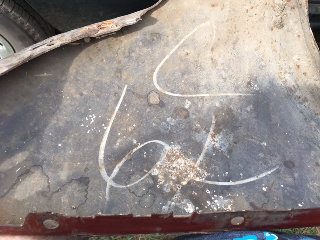

I need to have some small touch up work done on a 26k survivor L78 (endura bumper paint cracking). I decided to take stuff further apart just to clean everything up really well. The fender extensions each have a white "6" marked on the inside of them. Any idea what these were for? I'm just curious as I can't recall seeing them mentioned. Thanks!

The fenders were pierced for badging by Chevrolet. Box 103 on the BBC has a code for it. There was some worker shorthand on the line; COPO extensions are often marked 427 M.
In your case a 6 could indicate 396 badging.

It is my experience that the &quot;6&quot; is short hand for 396...BKH

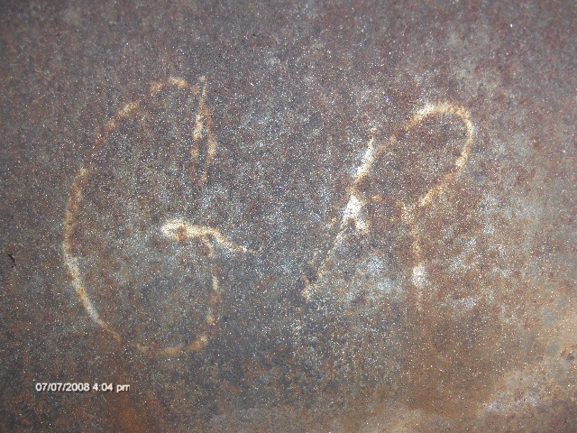

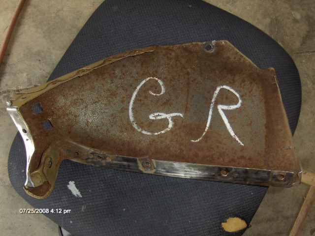

These are
on my Z. Friend says these are swap meet parts!
