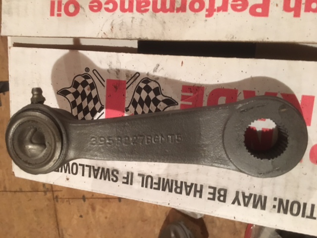

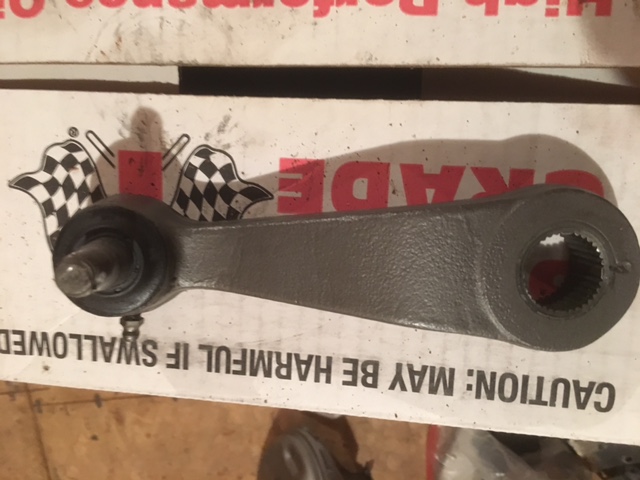

Anybody have a fast ratio pitman arm that they are willing to part with or trade for a manual arm? Pictures of manual - nice part.
Attachments - The Supercar Registry pitman arm 227 2.jpg pitman arm 227 1.jpg DSC01280.JPG DSC01279.JPG

Bergy, I guess I'm confused as to which pitman arm I have. Its hard to read the casting number on the one you have pictured. Is it 3953327 BGMT5?
Mine is 3953227 GMT1B. It is on an early 69 manual box that I have had for years so I assumed it was correct for a manual.
Thanks!

The pitman arm 227 is the quick ratio, and used on both manual and power steering, however the PS arm has a much larger splined hole. Again the casting # is the same, but the power and manual arm are not interchangeable.

Steve is correct (of course) - larger hole on the PS arm. Also, sometimes has a "P" stamped by the hole.

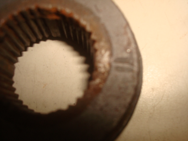

I have this one it is very good shape with no play. It doesnt have a P or M stamped it has a double hash mark, but it measure more than a inch in diameter at the box end.

My parts are in PA and I'm not there at the moment. Can someone confirm "greater than 1" on the box side" is the PS arm?
