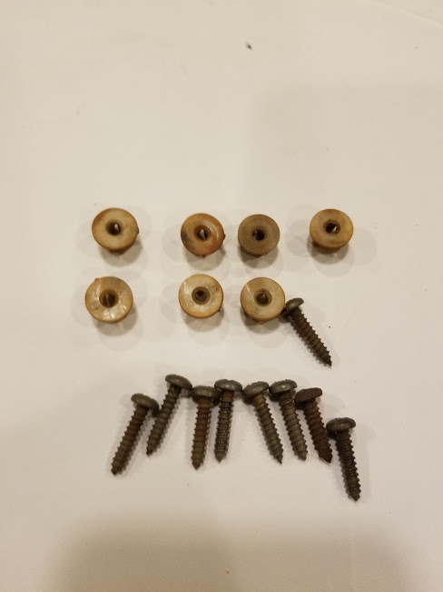

Rick, while studying your pictures today I noticed the white square grill mounting nuts. Are these what came on your car originally? My 69 Baltimore convertible had round grill mounting nuts( I have parted numerous 69 Baltimore cars and have found round ones on all of them as well. the originals I have are very brittle and I have been trying to find "correct" round ones. See the pictures attached. As you can see these are all a yellowish color, do you know if they where white and just turned yellow with age? thanks so much for posting all of these amazing pictures and assisting me with my restoration,

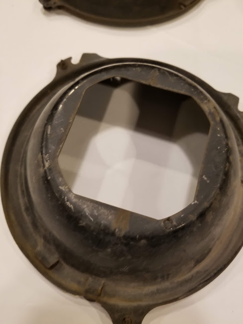

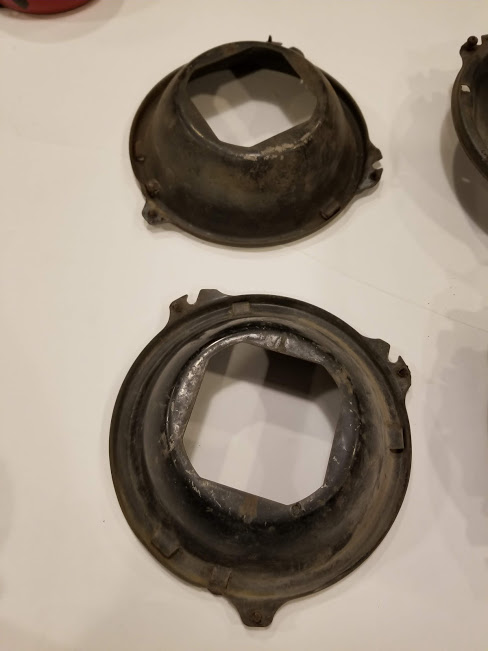

Rick it also appears your Headlight retaining buckets are a natural metal color - I was only able to see a small portion on your grill mounting bracket pictures. my originals are black(see pictures attached) I have not touched these and they are in the exact state that I took them off the car. I was just about to begin restoring them.

There was no front clip with the car other than the fenders so I cannot say for sure on the grille mounting nuts. What is currently in place are aftermarket ones.

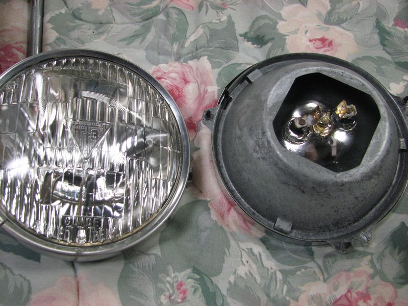

Regarding the headlight buckets I did find the originals in the garage and they were galvanized steel. I have found this on other Chevrolets and believe it to possibly be a supplier thing. A good friend of mine who also has a Baltimore car has the black buckets in his. As I have said many times in the past, I restore our cars how we find them if we are reasonably sure the parts are original. In the case of our headlight buckets I have no reason to believe they were not original to the car as they all had slight damage from the accident.

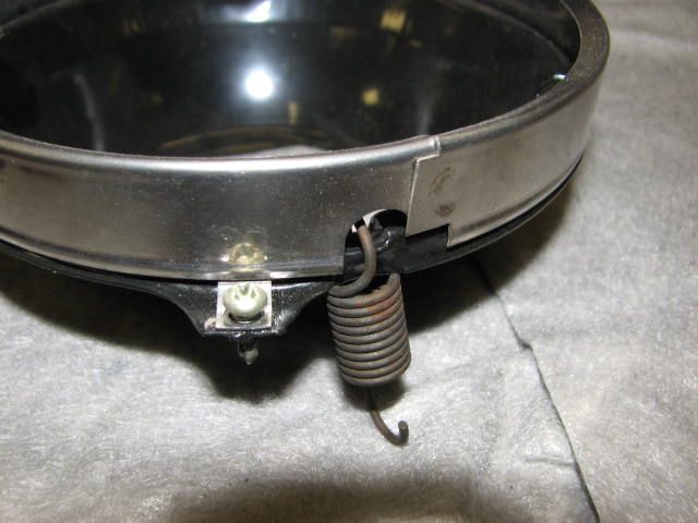

The other difference is the galvanized buckets take a closed stainless trim ring spring hook hole and the tension spring attaches to it (also found in the garage) whereas the painted buckets have an open spring hole and the tension spring attaches to the bucket. I can post pictures of each tomorrow.

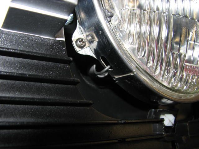

I thought I had taken several photos of my buckets as found and during cleanup but could not find them this morning. At any rate, the uninstalled buckets and light show how they looked in their natural state prior to installation. The second two photos show the difference between the trim ring on the galvanized bucket vs the trim ring on the painted bucket with regards to how the headlight adjuster spring attaches. The galvanized bucket has an open slot where the spring would normally attach so without the trim ring there is nothing for the spring to hold onto.
