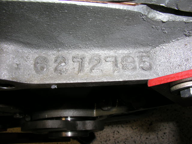

Looking for info on this engine i found . Went to get parts from this 75 year old and came across a big block chevy engine . It was dark and all i could see was valve covers that said PRO/STOCK .The gentleman said they didnt make many of those thats a can am all aluminum engine said its a friends and its for sale didnt get a price he moved out of state . Went back with a light block # 321270 didnt pull valve cover for head #s.Does any one here know anything about these engines

If the # started whith 0- its a prototype Cam Am Block like this.
0-326711.....................4-bolt, Alum., CanAm, 4.44" bores, steel cylinder liners

Here's some Alum. Mk1V block casting #'s and info I have saved also posted in previous threads here before..
Please feel free to add the missing &amp; more info also clarify and/or correct any mistakes..
Can-Am blocks 68/69 - Reynolds
# 0-294550 = Linerless?
# 0-321270 = Linerless?
# O-326711 = 4.44&quot; bore with steel liners (427 ci)
Can-Am blocks 70/71 - Reynolds?.
# O-399204 = 4.5&quot; bore and steel liners (509 ci)
# O-495102 = 4.5&quot; bore and no liners
ZL-1 Factory blocks - 1969 - Winters
# 3946052 (No 'O') 427 ci.
ZL-1 Factory blocks - 1997 &amp; up
# 3946053 (No 'O') 427 ci.
# 3992038 (O?) * may be 4.44&quot; bore w/ Liners - era?.
# ? - Yenko - Casting has YENKO
# ? - Yenko - Casting has Y E N K O
# ? - Yenko - Casting has Yenko Crest Logo
# 3946502 is the # quoted on the Guinn's Engineering site but the # is actually 3946052 as shown in their pics..

4,44&quot; Bore, thats 430 CAN-AM.
4,25&quot; Bore is a 427
0- means that its a prototype.
