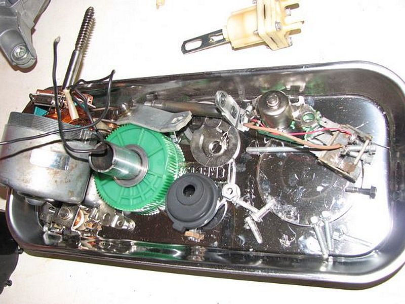

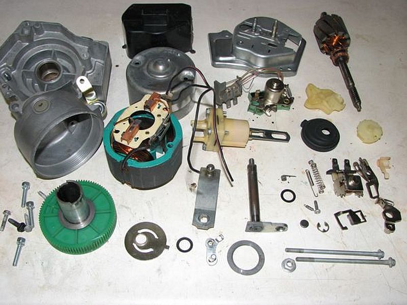

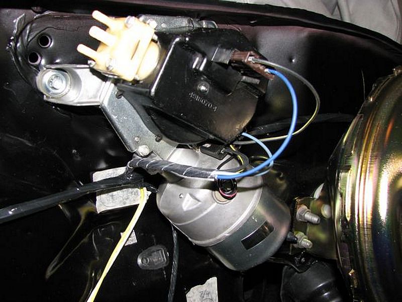

Some of you gurus out there let me in on the secret to separating the electric motor from the motor casing as seen in this photo. The Chevelle Chassis Service Manual has some great detail on the disassembly but nothing specific about my issue. I am in the process of restoring this wiper motor assembly and will be plating the casing. Thanks!

I believe the winding core is a slight press fit into the outer housing. If you can hang onto the winding and tap the outer case lip, it may separate.

I have restored many of this type. You need to use a puller to remove it. It can be reinstalled by pressing it back. A real hassle and not for the faint of heart. It is a cadmium finish.

You have to make a device that threads in to the bottom, and pushes it out against the device that grabs the bottom of the field support or shoe. Of course bend the tabs to remove the brush board and armature first.

They are a complete pain in the a$$ to restore. I have done them on almost every car we have restored. The two hatch marks you see on the side of the cover are on both sides and that was used to hold the housing tight to the windings. I have had fairly good success by running a small but stout rod through the bolt holes on the end of the housing and gently tapping on alternating sides of the windings on the bottom to gently push the them out but real care must be taken. For starters you can bend the windings if you get too aggressive and also if not very careful you can break the brush end of the windings if the armature is not held making it useless. I have never been able to get any type of a puller to work so would love to see and hear how others have done it.
Before you remove the winding and armature assembly from the main housing you also need to cut the two wires. That is a whole other subject. LOL
I used to restore these for mail in customers but due to the intense labor I cannot do them economically for the customer and still make any money so we only do them on our full restorations.
