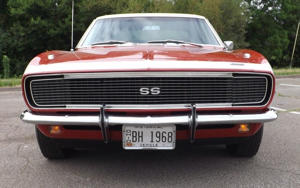

Probably the most loaded '68 I've ever seen. Not necessarily my cup of tea, but it's neat seeing all the factory accessories on one car.

I believe the luggage rack is not a GM item. Very interesting car otherwise.

A friend that has a couple GM luggage racks says that is probably a JC Whitney or other non GM. He also pointed out the underhood light is on the wrong side of the car. It is supposed to be over the dipstick. Also the fiber optic piece under the rear window does not look right.

Good call Charley...the luggage rack is just bad.

Neat car, but no documentation to prove any of those options were fitted to the car as-built, plus the P-o-p looks like a second owner style, without drivetrain details.

Interesting car...but I think it has been apart before. Looks like the SS emblem is upside down on the front grille.

plus the top and bottom of the grill are missing black paint.

And the headlight doors are not aligned very well.

Probably the heaviest '68 Camaro ever made and changing spark plugs on the passenger side gives the owner a glimpse into the life of a BBF Mustang owner.

I noticed the sales invoice said DEMO. I saw a similar equipped 68 a few years back that had been a demo for a Seattle area dealer,lots of the same options. I wonder how long it had been a demo as the sale date is Aug 1968.
