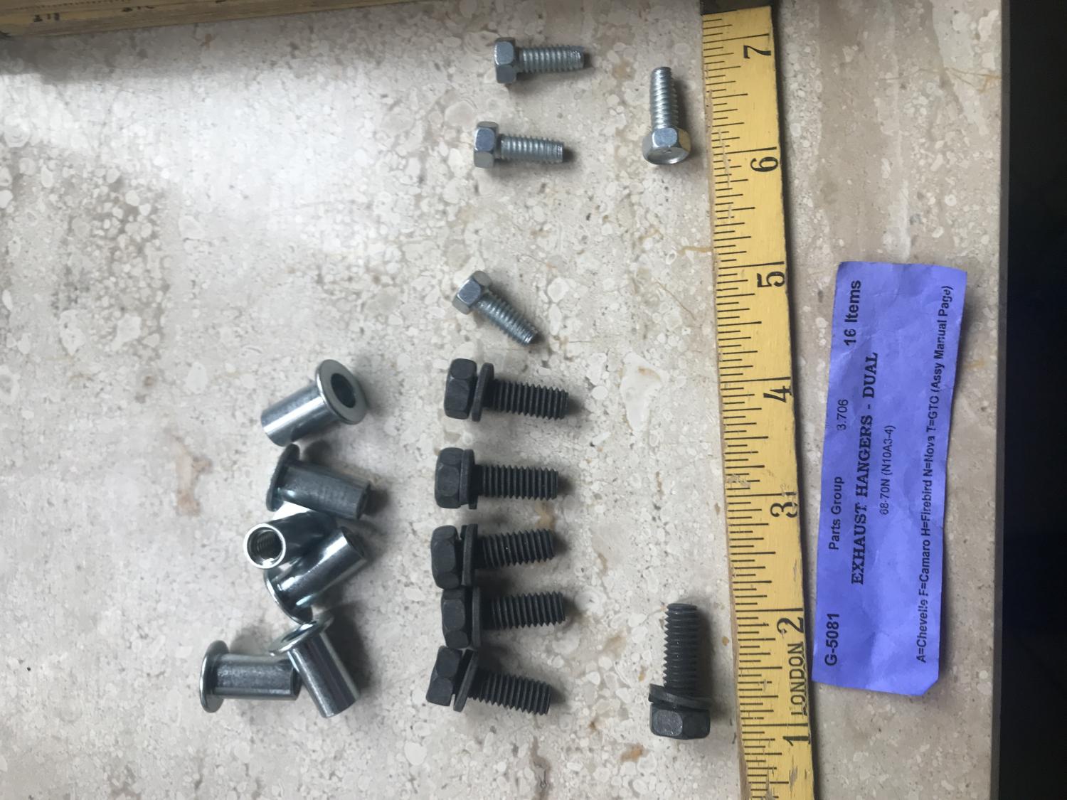

That grease is high temp clear silicone. Here’s a pic of my nova hardware.

What are those inserts for John?

Well nuts. They go into the rear of the floor board. 69 Nova has 3 for each hangar. Camaro has 2. If your car has Factory dual exhaust they are already in place. If not there are dimples there and you drill them out and put in the special nuts. Just so happens my amk package came with them. But the car has them installed from the factory.

RIV NUT = Steel or Other metal clinched threaded inserts. (Console & Exhaust)
WELL NUT = Rubber encased Nut (Radiator or Voltage Reg)

Hope this helps others. Did a little digging this A.M. and found something that looks to be close. (From research off T.C.) Looks like too much hardware for chambered system though. It's amazing the brackets that bolt up to the floor bottom only require one bolt. Now I just have to figure out where that bolt goes. The AIM is unclear, at least seeing it on paper.

Bolt goes through one of the metal brackets in the middle of your photo then through the over axle strap and into the floor pan - - orient the metal re-enforcement with the TAB pointed towards the floor boards (UP) The TAB acts as interference against the floor pan so you do not over tighten the strap -
