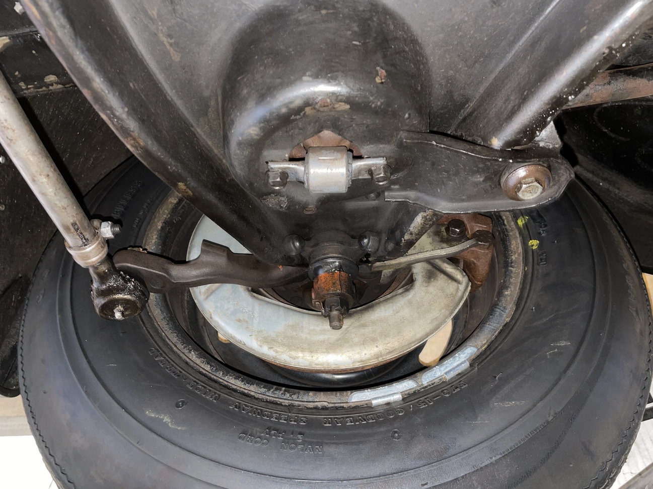

Back when I restored my 69 Z, I (like most folks at the time) had them plated silver cad.
They came out very nice, and are still looking good today.
Then I read a thread on here that they SHOULD have in fact been galvanized.
Tearing down the 70 Corvette LT-1 chassis. Dust shields look about the same as the ones on my Z before plating. Dull silver color.
Question: what is the correct plating?
Attachments - The Supercar Registry Used-1970-Chevrolet-Corvette-LS5-NCRS-Top-Flight-Bowtie-Award-Bloomington-Gold-Benchmark-1705499.jpg tn_IMG_0698.JPG RF3.jpg RF1.jpg

Where are these shields located?

This is from my 8900 mile car......

Thanks. I have three that look almost that good. Any idea how it is plated?
Silver cad? Galvanized? Painted?
This car is not getting judged, and will have a couple of day two parts. But, I still want it somewhat correct for when I go to sell it.

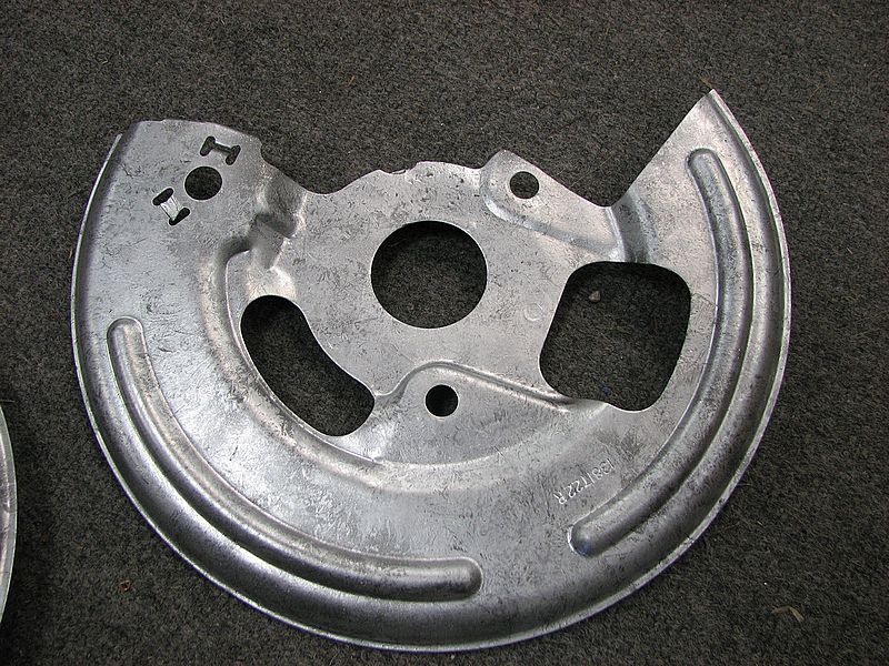

Originally Posted by 70post View Post
I think the only option these days is to have them clear (silver) zinc or cad plated. Repros are zinc plated as well. I've seen where people take things like crumpled up foil or cellophane rubbed in a silver paint and then "dabbed" on the surfaces to try and emulate the galvanized look.
Galvanizers are becoming tougher to find for sure but I was able to get my originals re-done through an ornamental iron supplier I work with.
Jake Dykstra

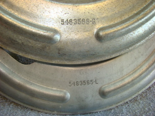

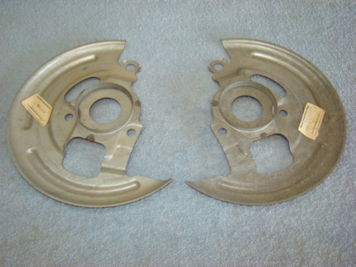

Jake, those look fairly accurate. I have yet to find someone who could galvanize them correctly and yours are damn close albeit a little shinny. I did these using the mottling process 70post mentioned earlier. I think I got them fairly close.
The first photo is of a pair of NOS. The second photo is mine on top of the NOS and the last photo is mine overall.
I have also had mine zinc plated and then hit them ever so lightly in the glass media cabinet to dull them a bit. Those looked pretty good as well.
